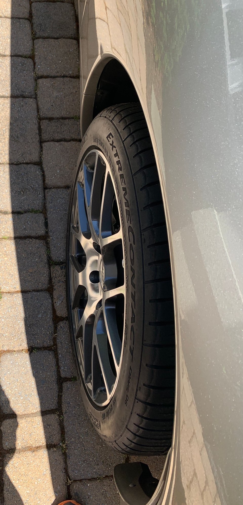

It's a wheel problem in that sense, and a difference in opinion on what "good" wheel fitment is. For an 18x11 rear wheel, Forgestar is going to send you a +55 or +53 mm offset, and it's going to poke a little like you're seeing. It's popular and it's what most of their customers want. Also with a wheel that wide, there isn't room to tuck it inboard much more. When you have the wheels mounted and car on the ground, reach in and feel how much space is between the tire and rear brake duct to see what I mean. An 18x10.5 is easier to fit inside the fenders.
I just got my own new set of Forgestars and have the same issue even with -1.5° of camber in the rear. It isn't terrible and I'm going to live with it, because you can really only see it if you're looking for it. From most perspectives, it isn't noticeable, and that's why you don't see it in most pictures on the forum. It's true that if you lower the car and/or align in some negative camber, you can hide the poke to some extent. Otherwise, the fitment you have now is still going to get you plenty of compliments on Saturday mornings at Cars and Coffee.
What tires are you using? Size and brand? Some of mine I think is tire. However there is someone on forum with exact same setup as mine. No poke at all.

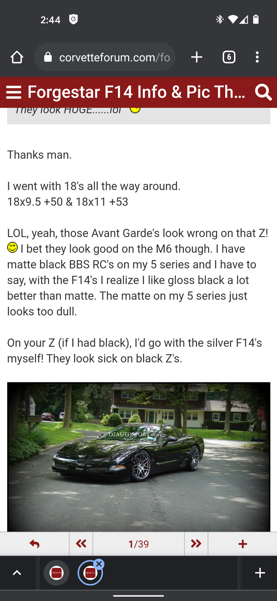

https://www.corvetteforum.com/forums...-thread-5.html
Post number 93 is the specs I ordered off of

MotoJB posted that picture. He also started the thread and in the first post he wrote "My rears do not stick noticeably out past the fenders" and "Minimal Stick Out/Poke with 295's". That description suggests to me that he had the same little bit of poke, too. Then look at his pictures in post #15 which shows the poke.
Z06 Forgestar F14 Info & Pic Thread - CorvetteForum - Chevrolet Corvette Forum Discussion

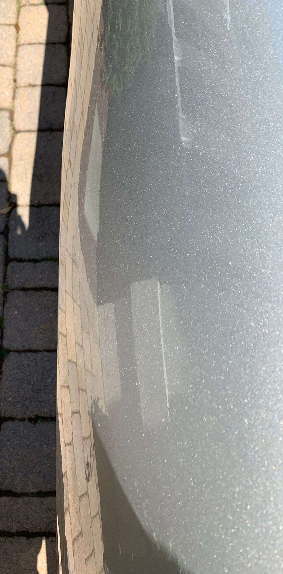

Hell I could live with that poke. Mine is 3/4 of an inch out. With a 295. I read that has he has little to no poke.

The other thing that has me scratching my head. Is I could have sworn the fronts were supposed to be 18x9.5 mine are only 18x9 and stick out 1/2 past fenders.

Then I'm not sure. It sticks out past the fender right at 3/4 of an inch
My CCW's were 18x9.5 with +48 offset and the rears were 19x11 with +54 offset. Tire sizes were 265/35/18 fronts and 305/30/19 rears. Rear poke was less than 1/4" in the rear and approximately 1/8" in the front.
Yes, it could be an alignment issue, especially if you haven't had it checked in a long time. If your front wheels have at least 7" of backspacing and the rears have 8.125", there's not a whole lot else it could be,
BTW, have you driven the car since installing the new wheels and tires so the suspension had a chance to settle?

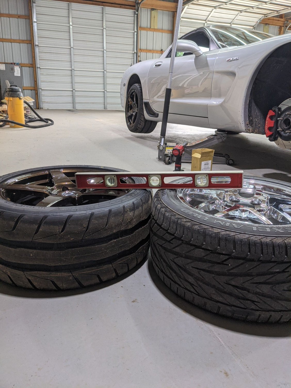

Old wheels and tires are OE wheels. The chrome wheels are marked 17x9.5 275/40 rear 18x10.5 295/35. I ordered 275/35 for fronts because I moved up to 18 inch wheel. Thats what forgestar rep said to use. I didn't see a problem because I thought I was getting 18x9.5. I would think a 265/35 would fit a 9 inch wide wheel better?..

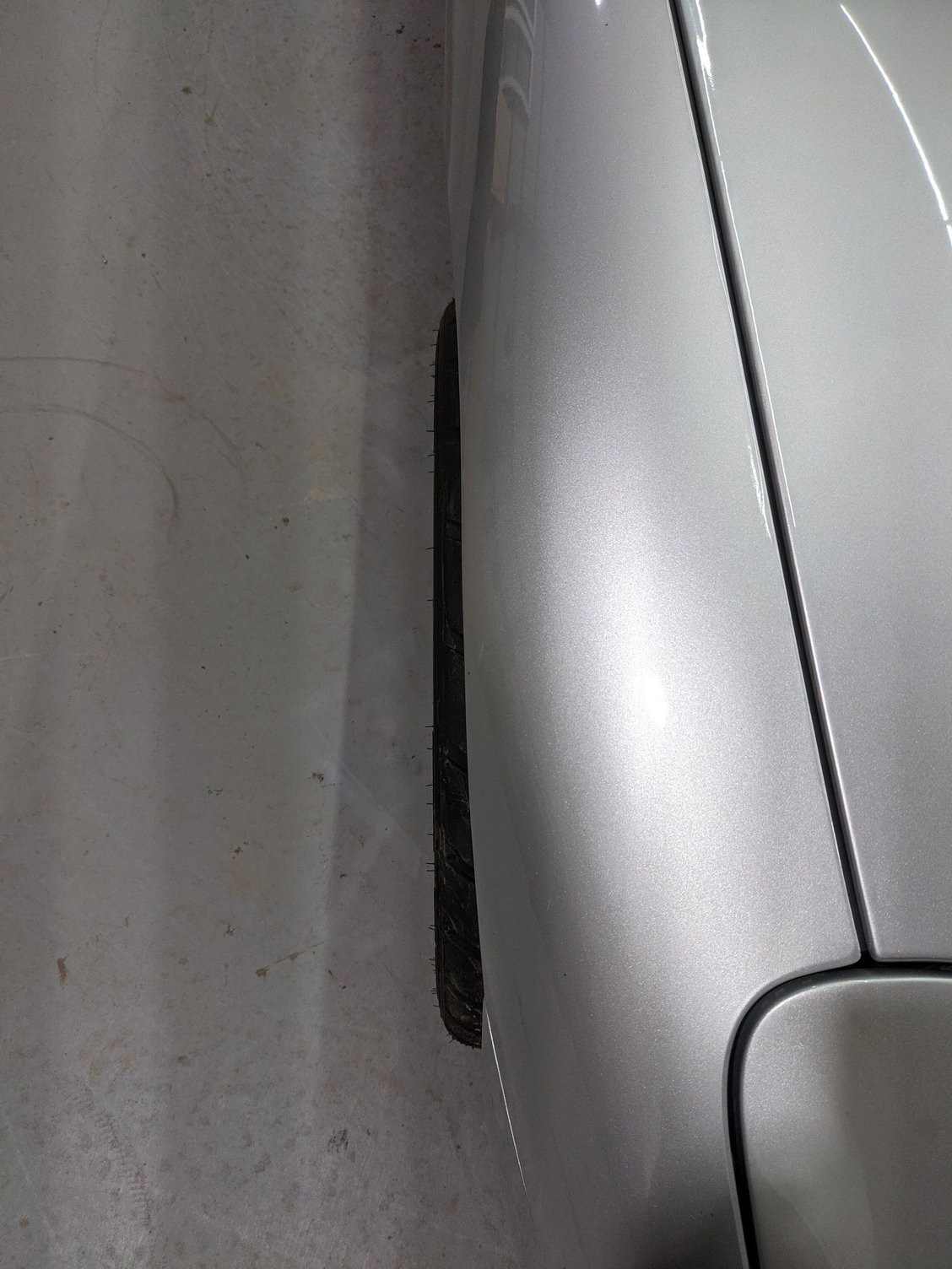

Following pix are of my car with 18/10.5 wheels on the rear with 295 tires. One pic is from as vertical as I could estimate, the other a few inches to the left.

Ahh OK. Use that website I linked. It has one tab to compare wheels of different sizes and offsets. It also has a tab to convert from offset to backspacing (since that is what you are measuring in your garage).
Stock C5Z
Front:
Wheel size: 17 x 9.5
Offset: +54mm
Tire Size: 265/40/17
Back Spacing: 7.38” (187.35mm)
Rear:
Wheel size: 18 x 10.5
Offset: +58mm
Tire Size: 295/35/18
Back Spacing: 8.03” (204.05mm)
So I think you said you had an 11" wheel with 8.125 BS? That equates to a +54 offset. Since the stock wheel is 10.5" +58 and new one is 11" +54 that puts new wheel 0.16" further outward. Keep in mind you are measuring to a tire sidwall bulge in which not all tire widths across all brands are the same. So that COULD account for some of your visual "poke".

Offset on rear wheel is 51mm according to online calculator. Fronts are 44mm. This is without the tire bulge. I cut something to fit on the flange. To get more accurate measurement.

https://www.1010tires.com/Tools/Whee...et-Calculator#
This says your 11" wheel +51 will stick out 13mm more than 10.5" +58 which is about 1/2"
