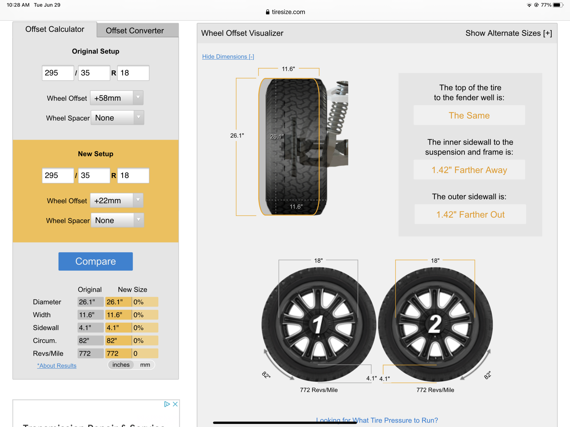

Vernon, this is what I got on tiresize comparing a stock Z06 stat with one with the +51 you mentioned.

This is what I get for the fronts.

Vernon, That’s reasonable. Do you have stats on the new rears?
