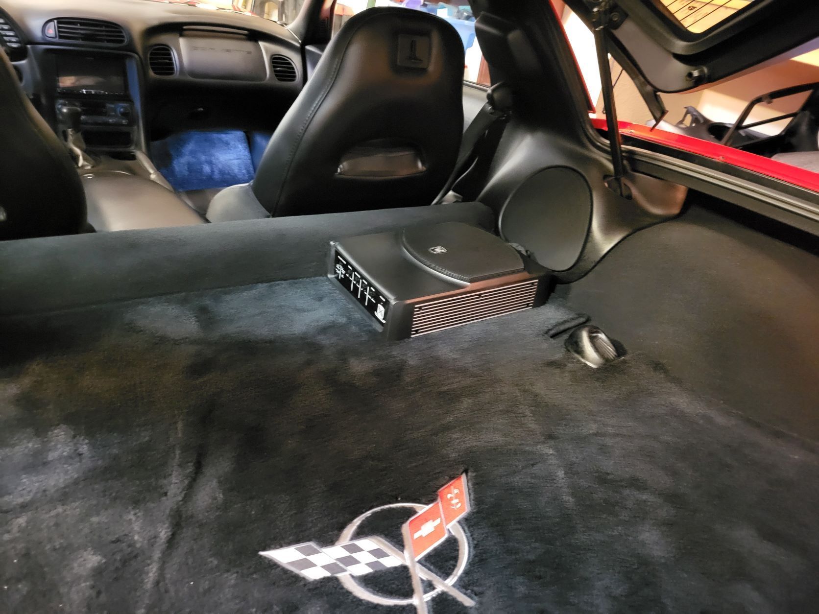

Purchased my 2003 coupe about a month ago, and the audio system was the stock OEM Bose system.
Replaced the head unit with an Alpine iLX-507, which took about 3 total hours (including wiring the module you need to connect to the Bose system's amps). You'll need to drill out a few rivets to remove a couple of metal braces in the dash, and you'll need a module and a new trim bezel for the double-DIN install, but it's all fairly straight forward. Crutchfield will supply you with the detailed instructions for each step (and hook you up with the module and trim you'll need). You can either hook the radio up to the parking brake per the instructions, or just grab a small switch from a local Autozone to mimick the engagement of the parking brake (which is what I did- start up the car, click it off and on, and you can access any of the functions on the radio).
The result with just the new head unit was pretty good, but I wanted a bit more bass. For that I installed a SoundOrdnance 8" powered sub. That install took maybe 90 minutes to 2 hours and was very straight forward. The feed to the sub is a simple RCA connection to the aftermarket head unit, and there's an easy pass through the firewall using a rubber grommet that is right behind the battery. The sub is small enough to sit right behind the seat and not interfere with roof panel storage, and the interior volume is pretty small, so even a relatively small sub makes a decent impact.
The stock speakers sound great to me, and I'm pretty content with the system at this point. I have wireless AndroidAuto (works for Apple stuff too). I did not bother with a backup camera, but Alpine sells one which is an easy install (and I'm sure every other manufacturer does as well).
