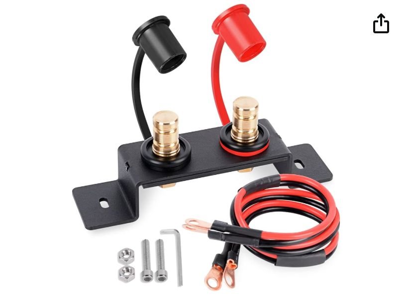

If you are inclined? Good idea to run remote battery terminals for charging and jumping

If tracking, then listen to the other guys as far as placement. If you go inside the trunk then ensure you have remote jumper access. If you go on top of the rear bumper inside the fascia, ensure the same.

Even with the trunk closed, you should be able to jump the car from the post next to the fuse box under the hood, and anywhere a good ground can touch.

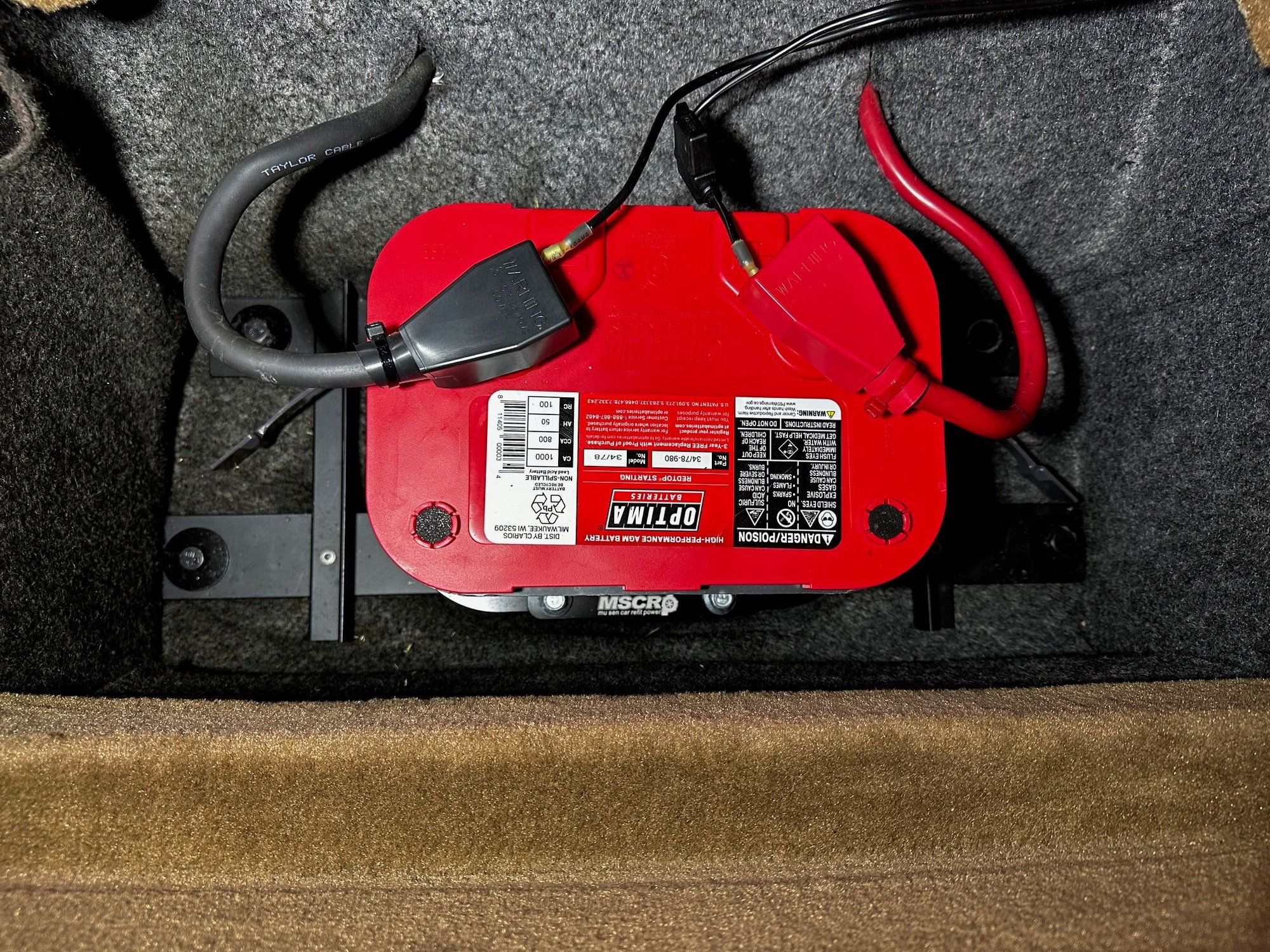

I got all the parts .
Optima battery trunk mount.
2 AWG cable .

Good luck with the install, you will need to pull the exhaust, the torque tube cover and route the cables in that area. Make sure you clamp the cables well so they cannot move around and rub things. My car had the battery relocated by the prior owner (Zip Corvette) and they used the good stuff, BIG cable and ran both all the way back up front. I would not use that short ground in your kit, not that there should be anything wrong with using it, but these cars are just so finnicky with grounds. You will certainly have better weight distribution and all that space open in the engine compartment is really nice too.

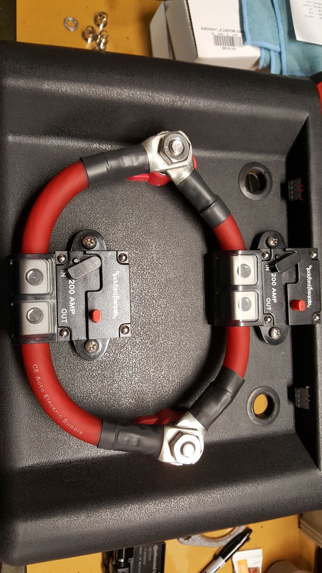

Originally Posted by schmuckingham
Like others have said use good large gauge wire. If this is a daily driver I would suggest running a negative cable from the battery to a post up front to keep the grounding points in the car happy. I would also suggest running two main breakers right off the battery, just in case you loose a breaker for some reason you have a back up ready. Example of what I mean, this is the battery box in my Soarer.
This a great idea, our boat has the same setup and for some reason I never considered it for the Vette, but I am going to install a breaker or maybe 2 now! Do you recall where you found that panel?
