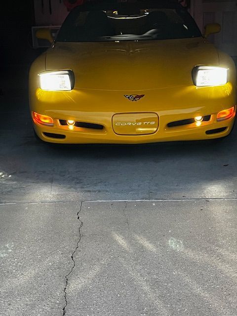

Is this what you recommend?
If you rarely drive at night like you stated then to me spending close to 700.00 is absurd. My vette sits in the garage and I do not drive at night. If aimed correctly the ones I have are just fine. I recently installed led's on my 2020 Impala. (worse lighting than the vettes) And they mount in a specific way. If you do not then yes, the light scatters. Aligned mine work great

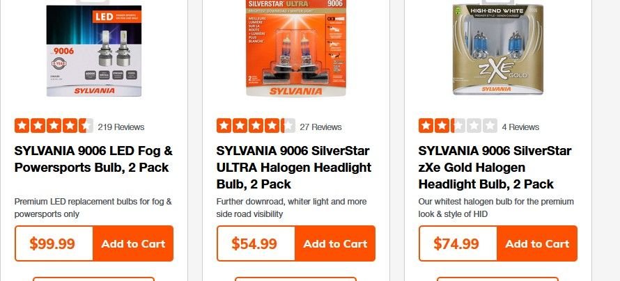

Originally Posted by Tim04C5
If you don't drive at night much and all you want are working lights, Is there any reason to not use original type lamps? Wouldn't they work 'normally' without issues? Or would this be too easy?.....
You could go with a name brand like Sylvania and get an ugraded 9005&9006 bulb.
To LED Headlights
