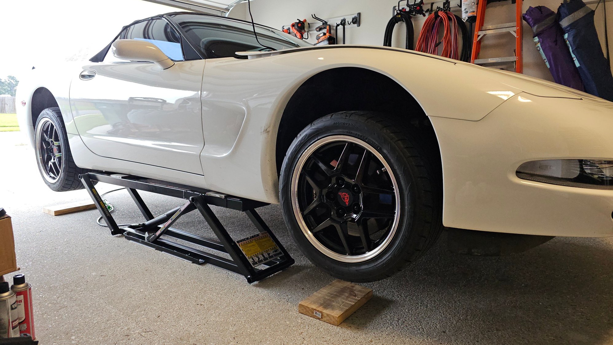

I use a 7000TL model so I can also lift my truck and it goes to 24" height. The lifting points on the Vette are too narrow to use the lifting areas on the jack so I use some 1/2" steel plate on top of the quickjack frame for the four lifting points on the Vette. I haven't done any drivetrain work but it seems high enough. The picture below is only raised halfway when I did brakes a few weeks ago.

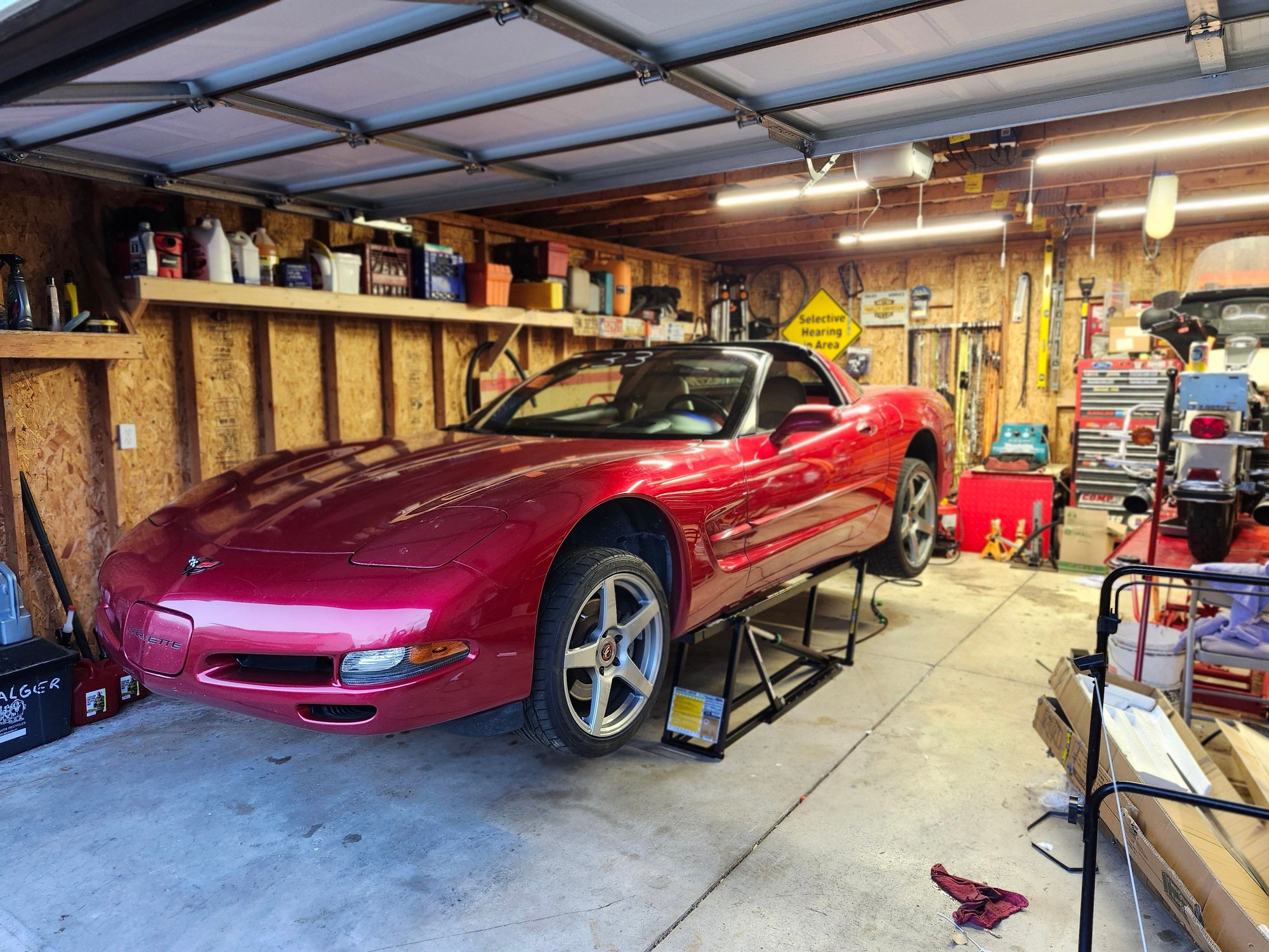

I ended up with a 3500 lb set. I'll post about my experience once I get the car lifted with them.

I finally got to try out the quick jack 3500. They fit the car perfectly. The spacing between the pads is just right for the lift points on the Corvette.
Good to hear. I’m half tempted to buy the 3500 even though I already have the 7000SLX just because the 3500 would be so much easier to move around.
