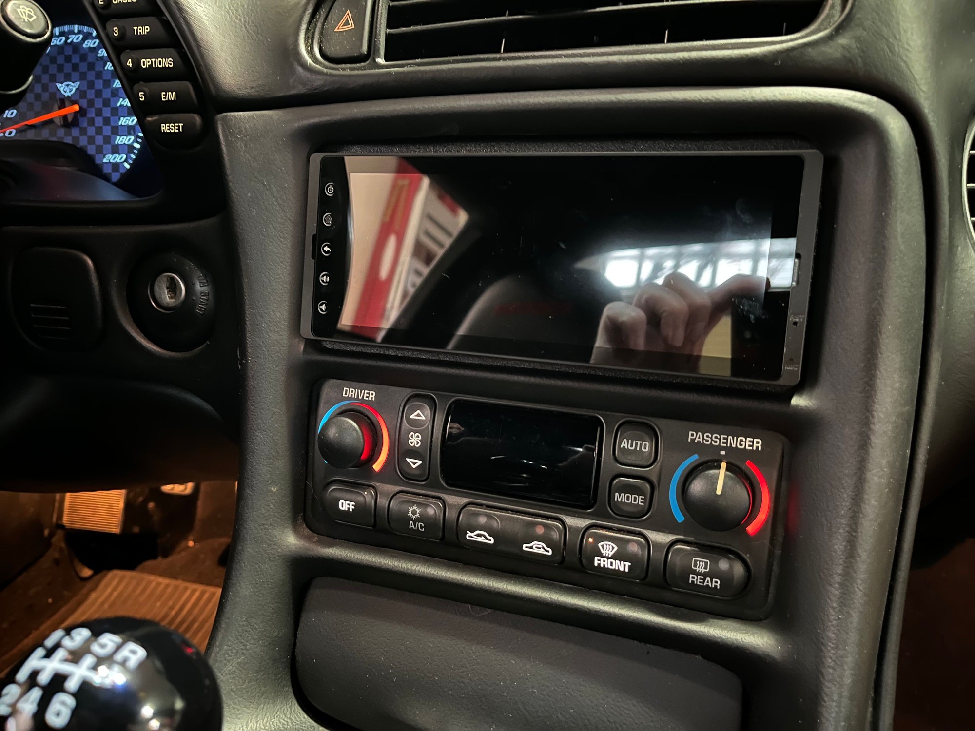

Install complete!
I bought the radio directly from Amazon and then used the PAC VET1 harness instead of the Axxess.
Amazon Amazon
This is a major upgrade over the other 1-DIN radio. Got the factory Bose subs working this time too.

Originally Posted by roegs
Thanks for the info. Do you have a link for the radio you purchased? Also, did mounts come with the radio to get it centered etc? One of the big selling points for me on the kit from Reversion Raceworks is the 3D printed mount.
Yes, it was the one posted above, that appears to be the same one from Reversion.
Amazon Amazon
Mount it, buy this kit from Metra (I already had it from the previous install)
Amazon Amazon
I've looked at many photos of the Reversion Raceworks installation, and they look beautiful. I can't help but wonder if the Metra kit would be as precise.
here’s my install with the Metra:
