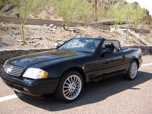

i had a 2000 for 10 years, triple black!!
