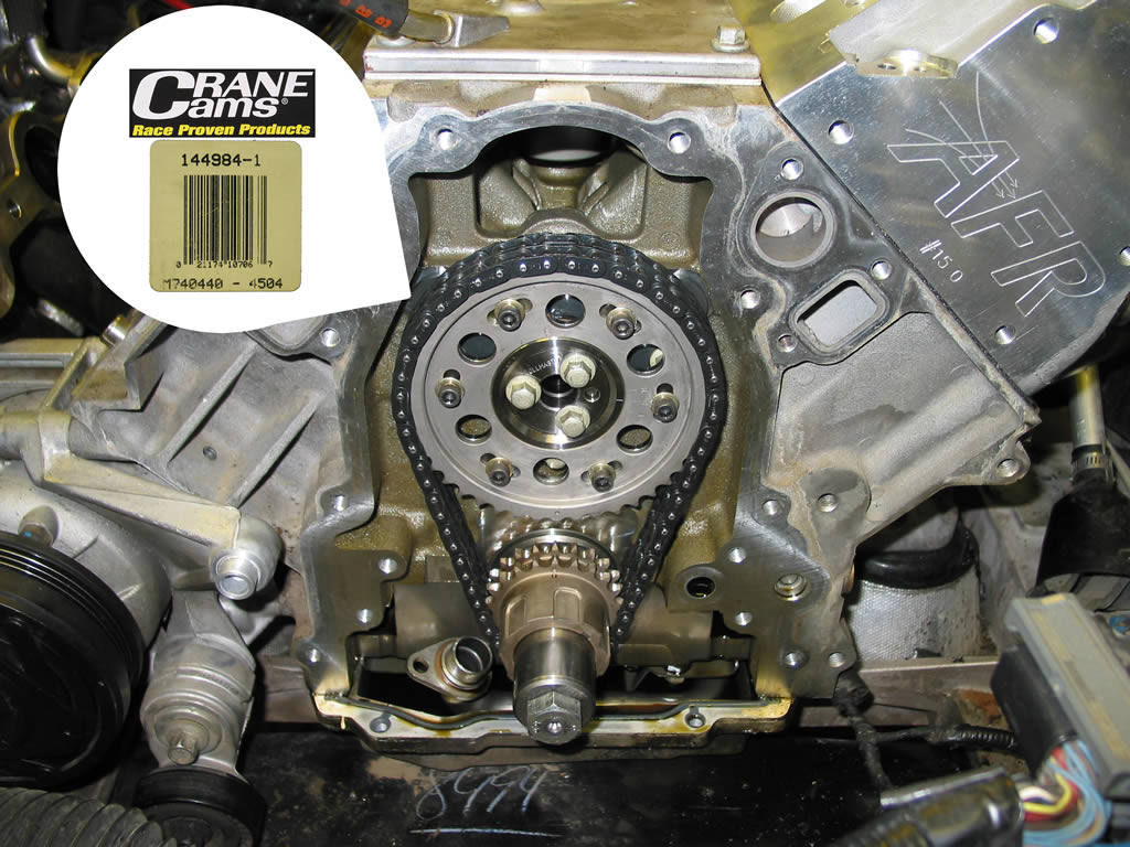

Originally Posted by peter pan
Or like me you can goto a double roller setup
Been seeing a lot of problems with these single roller chains lately. I too went double roller. I really like the Crane chain, it has Rollmaster stamped on it so I assume that who makes it for crane.
That looks like mine did, oh I bet I used the same one, those AFR's look great on your motor
This is why I went with the top adjustable chain. Oh yes, I love the AFR's
Not to hijack but-- is that a home brew front cover?
Looks good.
