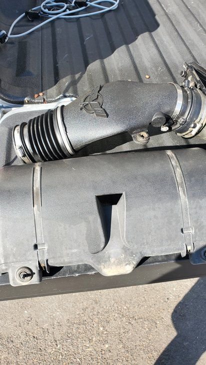

Do they look the same as the 2001 Z06 Covers?
My 2004 has this one (although I bought it used).

You'll do a lot better if you start a new thread. This one is 15 years old!! Some progress, and a lot of new ideas have happened in the interim!!
