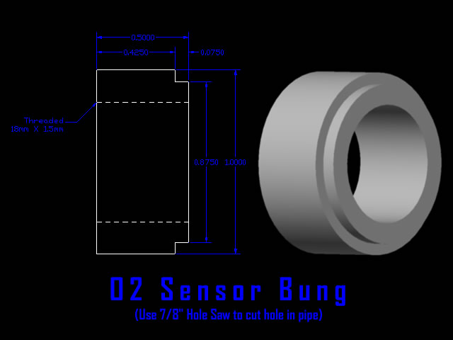

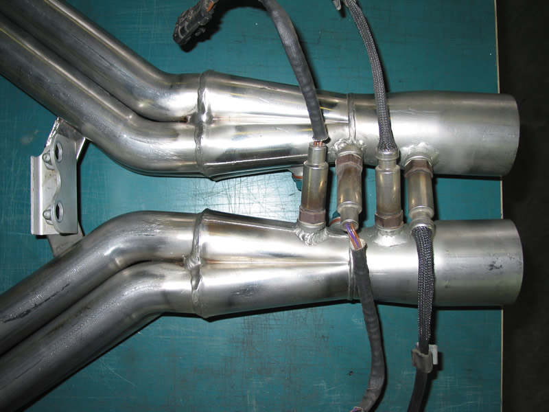

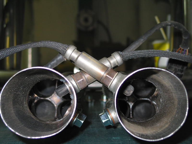

Here is the setup I'm running. I welded two extra bungs right behind the factory LG bungs for my permanently mounted dual LC1's. Note, these are all factory O2 sensors screwed it to make sure everything fit OK, didn't have my WB O2 at the time of the header install.
I also welded two bungs in the lower side of the pipe just in case I ever needed quick access to the pre-cat exhaust. If I pull it on a dyno I can simply screw out one of these bungs and screw in a WB sensor or and adaptor to their sniffer pipe or anything else I may ever need to stick in here like a temp sensor. You should not run O2 sensors at an inverted angle very long, they can build up water in the sensor and damage the sensor. But for a quick check it works great. The plugs are cheap ($1.25 each) import oil drain plugs, even comes with copper gaskets!
I found a box of cheap stainless steel bungs on eBay. I stuck them in the lathe and turned a small 7/8" notch on the back of them. I used a hole saw to cut a 7/8" hole in the pipe, the bung will then fit flush in the pipe making welding easy. I had to weld in my own after cat bung for the factory rear O2 sensor in the X-pipe also. So I did a lot of bung welding, running 6 sensors and have room for two more!

[QUOTE=SpeedyZ]Here is the setup I'm running. I welded two extra bungs right behind the factory LG bungs for my permanently mounted dual LC1's. Note, these are all factory O2 sensors screwed it to make sure everything fit OK, didn't have my WB O2 at the time of the header install.
Speedy,
You are fully bunged up!
I used the Ebay bung as well, but only a lowly, single.
