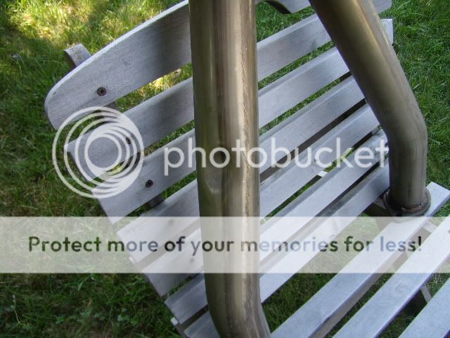

Just curious if anyone has installed one of those x-pipes from ebay that you have to weld in (the ones that are just the "x")?
Also, what size are the stock pipes on a 02 Coupe? 2.5"? 3.0"?

What are you expecting from this? Are looking to change the sound or improve performance? If sound, this may help some. If performance, I wouldn't hold my breath.

Sound is a major reason for this... I just put a SLP Loudmouth exhaust on and I not really liking the "motorboat" sound I am getting as well as the popping. I am hoping that putting an x-pipe on will get rid of these sounds (or at least reduce them).
Is there a performance issue with using something like this? Are the tight bends something that will reduce the current power? Or will I just not get any gains from this? I wouldn't expect much of a gain no matter what pipe I go with. Am I wrong in that assumption?

The X pipe design will have an impact on the performance gain/loss. By the provided photo the design of the one shown looks less than optimum to me, but I could be wrong. I'm basing this on visual comparisons to known good designs. By the photo it looks like the center area is too squared off, more like an H pipe shape than a smooth flowing X pipe. If the price is right it might be fun to try none the less.
Were you planning to tig or mig weld it?

The X pipe design will have an impact on the performance gain/loss. By the provided photo the design of the one shown looks less the optimum to me, but I could be wrong. I'm basing this on visual comparisons to known good designs. By the photo it looks like the center area is too squared off, more like an H pipe shape than a smooth flowing X pipe. If the price is right it might be fun to try none the less.
its the same "X" as magnaflow so i dont see how it doesnt work as well

You can buy the C5 X pipe in the used parts section all the time. For the cost it's not worth the trouble to make one. The MagnaFlow X pipe is all stainless too.
Really! Sure looks different to me.

Looks closer to the Bassani type which I have. If you have access to all that is needed for the swap, I'd say to go for it. It should help with the motorboat sound...
I was thinking the same thing... that's why I was asking if anyone had put one on and had any luck with them. It's hard to tell what is going on inside that thing.

That is a Magnaflow universal X pipe It is totally hollow on the inside between the in and out pipes, so there is no restriction. You can pick them up at Jegs or Summit for about $50.
Where have you seen the "universal x pipe" by Magaflow that looks like the original posted picture?
This is a Magnaflow, it doesn't look anything like the one OP.

Thats what I get for trusting my muffler guy I guess, then again the one that I saw was 3 years ago and its on my truck not my Vette so it's not like it matters I guess. Anyway it is totally hollow in the middle.
