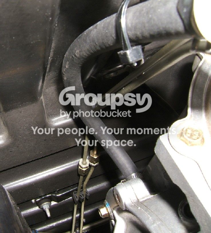

Re-resurrecting this thread again. ��
I'm in the process of doing this now. Used 3/8" fuel line hose and ordered the part. I know a breather can be used, but if it starts again, I'll just switch to a breather.
One question though. Has anyone had any trouble with the hose popping off the nipple on the diff? I think mine is on fairly solid now, but at first it would keep slipping off. I've got it zip tied up and ready to go. Also, do you guys have the free end of the hose pointing up or down...or does it matter?

Chevy has known of this problem for at least 15 years. A few months after buying my 2000, this problem started. I took it to the dealer and they did the hose trick under warranty. No problem since (15 years and counting).

Another resurrection...sorry, just wanted to report that I was able to get a chisel between the vent lip and the case...a little tapping, not too hard so I would not damage anything...after I raised the vent a little I was able to use a pry point and a hammer to raise the vent from the hole completely. No issues occurred, installed the new vent with a 14mm deep socket. Note, I had the rear end out of the car to replace a clutch and the fix the leaky butt.
