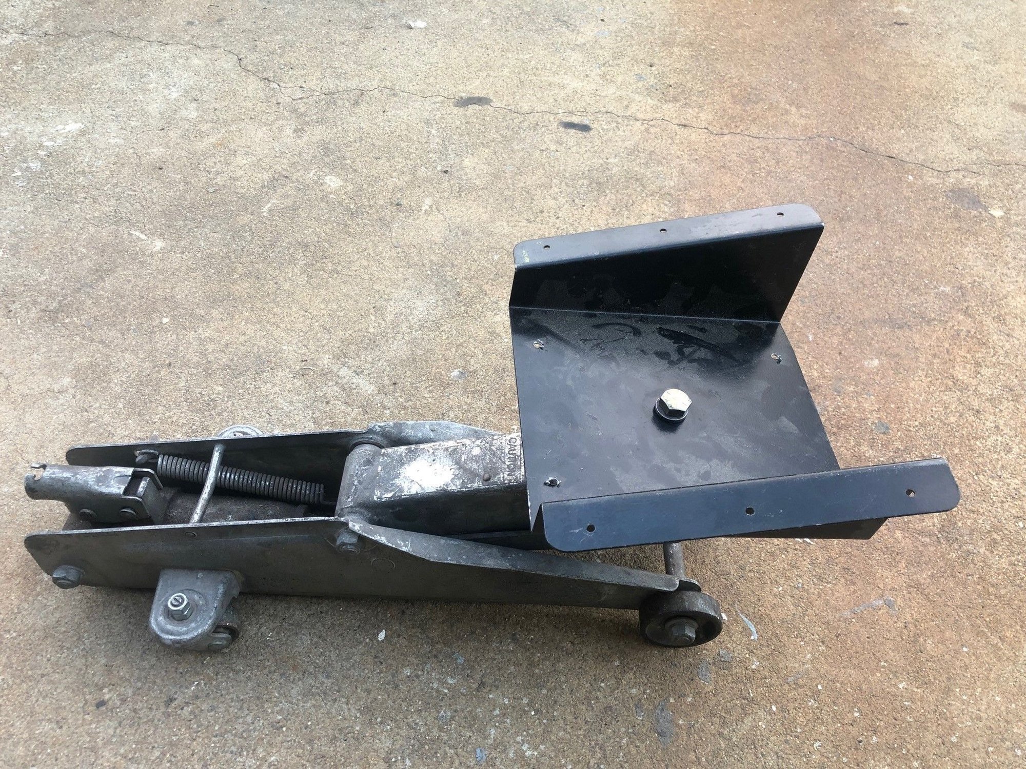

I have decided to bite the bullet and do it myself. Today I removed the drive U-Join, drive shaft and hurts shifter...strange that the U-Joint had no zerk fitting on it.
One of the things that was making me think of just having this done was that I benched pressed the Muncie in myself last time...laying it on my chest. Today I made this out of an extra well used floor jack I had. In the "cup/cradle" of the jack was a rivet, I removed it and welded a bolt on the bottom side...this way I can remove the black bracket. The black bracket was in my metal junk pile that was used to hold up a TV on the wall.
If I don't tighten up the bolt, I should be able to swivel the cradle. I'll strap it down and I should be good to go.....haaa...so he says.

Look at what I came up with above..
god i hope he changed has clutch by now. he would of had 7yrs to do it before ur cool stand.
