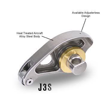

Doesn't someone make nice machined steel ones?
Jesel makes a beautiful set, but they are over $2K (ouch).

he may have been asking about the pedestal stands.
