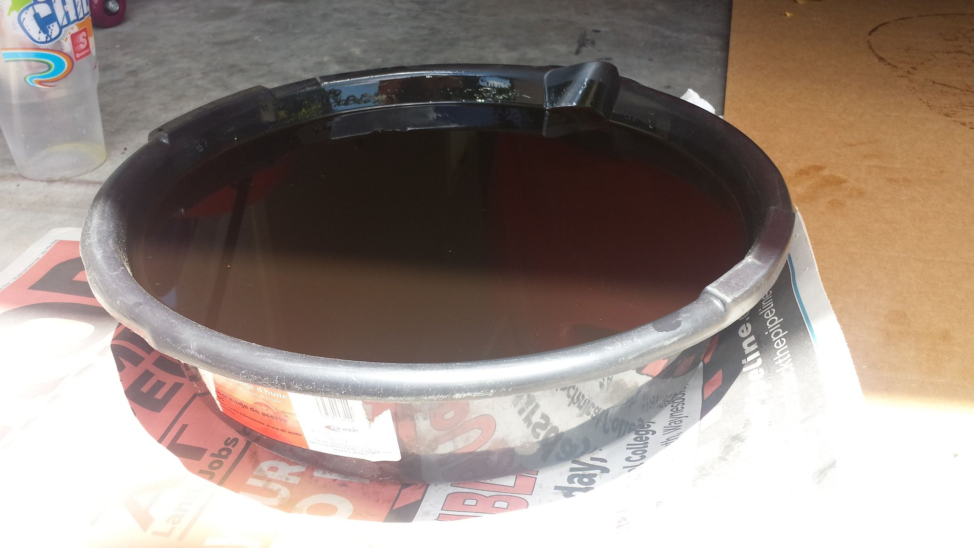

12. Redrained oil, the oil looks fine.
I think the pump is working since it draws the oil from the pan.

I have found no debris in the oil drain pan.
