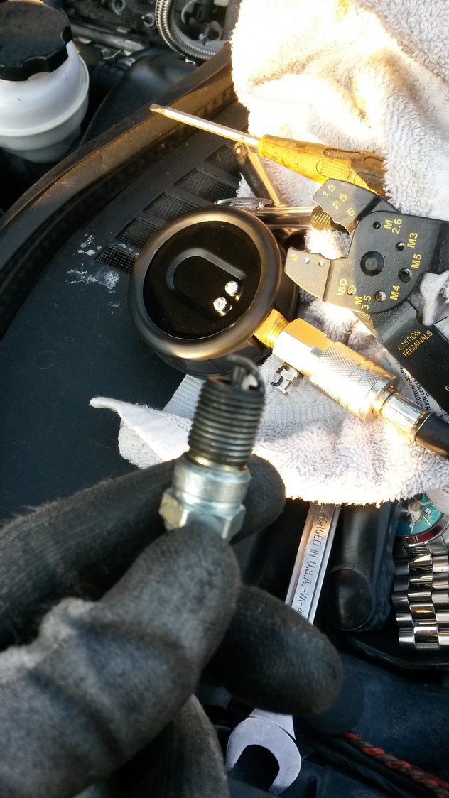

Cylinder on drivers side closest to fire wall did have a smashed spark plug. Looks like cylinder actually made contact with the spark plug, but compression was good.

None of the plugs were washed out or clean. The only plug with moisture at all was the plug that was smashed in the picture, but the compression was good.

That plug looks horrible !!! Bent electrode can only happen if something broke in that cylinder--valve made contact with the piston or a foreign object got into your intake manifold
