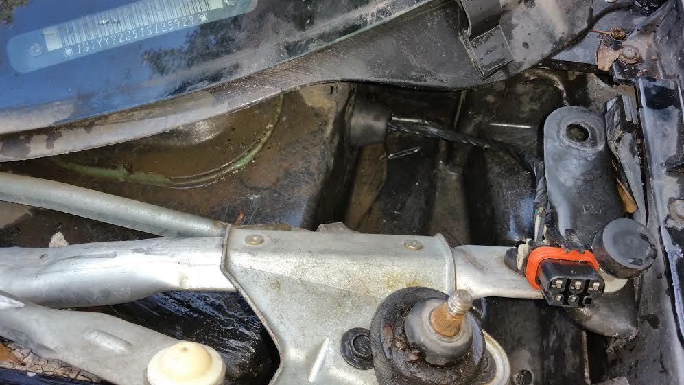

For several months now I've continued to find the driver's side carpet wet after a rain. Checked all the usual suspects. Utters were, and are clear. Tried running water with most of the panels pulled loose under the dash. Still couldn't track it down. Basically got pissed today and decided I would look until I found it.
Shazaam! Under the wiper motor, there are two "body seams" that come together. The "sealer" is cracked along about 3" of the seam and a small chunk is missing where you see the paperclip in the pics.
What I need to know is what do I try to seal this with? The panels move. The crack is tiny. I needs to be something almost the consistency of water to "flow" into the crack and stay pliable after dry so it doesn't crack again.
Any ideas?

That's an option but didn't want to go there. The area where the leak is is actually lower than everything around it. Water pools slightly there. RTV would probably seal the gap but sooner or later it will give up and the leak will be back. Trying to think of something that will either flow into the tiny crack or build up the entire area to where water won't pool.
Wife says "Flexseal"...lol. She may be onto something.
Anyone use it, if so how does it hold up over time?

ADD kicked in. Plasti Dipped the Be Jesus out of it.
If someone has a water leak and the usual culprits arent guilty you may have the same issue. Looks to me like a major design flaw. The inner panel mates under the outer panel forming a concave area for water to pool. If they would have lapped the panels opposite water would easily ran over and out.

It's all a memory now. That open seam valley is not a hill with about a half can of Plasti-Dip.
