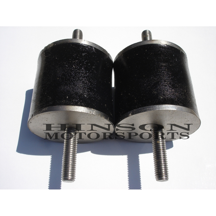

Pick up a set of our performance urethane mounts. They are stainless steel interlocking design that is anchored in our blended urethane. The result is a mount that performs like a solid, but dampens like a stock mount. Best of all worlds.
FYI our mounts do not require heat shields unless you are running road race sessions, or have tight clearances for something like a turbo car. If this is your case, we do offer heat shields. Again NOT REQUIRED FOR STREET CAR USE!

I've used three sets of these Hinson mounts. 2 in street cars and 1 in my 9 second race car.
I like them. They work great.

The Hinson mounts are very well made and a good design, but after experiencing driver's side heat deformation from my 1 7/8" Kooks headers on my street driven NA car, I was left with little choice but to install heat shields.
Even with stock rubber mounts, GM saw fit to install OE motor mount heat shield on a number of C5s and C6s. Heat protection for motor mounts is not a big issue or expense.
