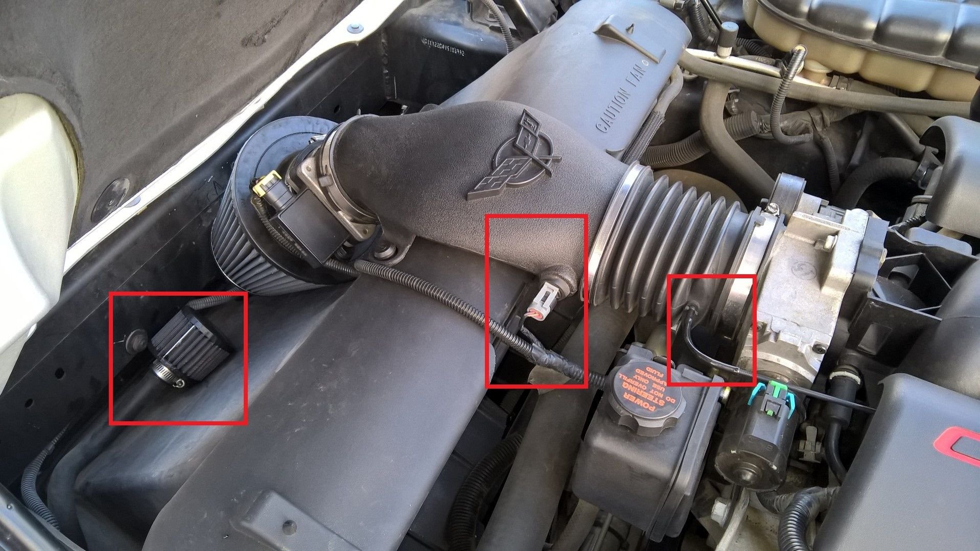

I'm ordered a VRM-VR-B2 Air Intake, and Power Duct for my 1997 corvette. The attached image (Intake.jpg) shows the current setup of the car as I purchased it. The car is also missing the factory fog light plastic holders (deflectors), and factory screws.

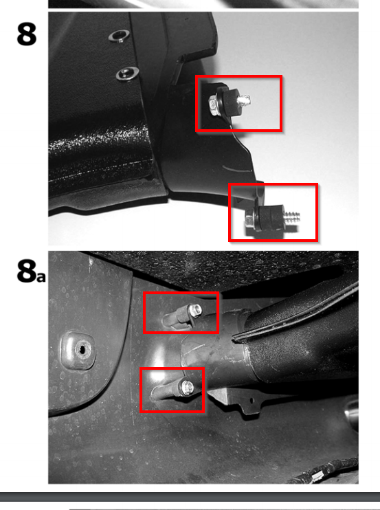

1. The installation instructions - http://www.vararam.com/VR-B2_instructions.pdf - Step 11 states - "try to re- use factory screws if standard c5". Do you happen to know what size/thread screw to use?
2. In lower left corner of the attached image, you can see a small air filter and rubber tubing which runs to the front left of the car and is connected to the secondary air injection pump. Does the rubber tubing need to connect to the Vararam Air Intake box, or is this

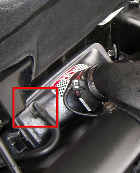

3. In the center of the attached image (Intake.jpg), there is an electrical connection, and a small black rubber hose. When looking at the pictures and installation instructions - http://www.vararam.com/power-duct-instuructions.pdf - for the Power Duct Systems, I don't see any place for these items to connect to the power duct. Where do these go?

do not use screws in the lower part let it float, makes a lot easier install and the service the filter !!!!!!!

Question 1: No idea. My 2002 Z06 did not have the foglight mounts so I had nothing there, either. The VR-B2 scoops are almost an interference fit once all the ducting is in place.
Question 2: That tube needs to stay and there is a factory plastic elbow that is used to attach that tube to the top of the air filter box. I'd try to find one from a forum member or supporting vendor and hook it back up.
Question 3: The power duct is not set up to accommodate the parts you mention. I think it is more for the newer C5's that eliminated those parts. Unless there is some kind of adapter or workaround, you'll have to keep the factory parts from the engine to the air filter housing. If you'll look at the power duct versus the factory bridge, you'll see that there really isn't much difference.

1. I'll buy a bunch of different screws from the hardware store, and see how it goes. Worse case, I'll just go with the interference fit and see how it holds up.
2. After calling a few places it seems the factory plastic elbow is obsolete. I'll see what I can dig up.
3. Thanks for the advice. I'll end up keeping the factory intake bridge and put the money towards something else.

Like pounder said...DON'T use the SCREWS... ask me how I know that

Ok, I'll forgo the screws. Thanks!
If I can't find the elbow adapter that connects the rubber hose from the Vararam to the secondary air injection (pictured above). Do you see any reason why I couldn't use a block-off plate on the Vararam, and keep the current setup which uses a small air filter hooked directly to the SAI?

I blocked mine off,as I have eliminated the air pump system !!!
