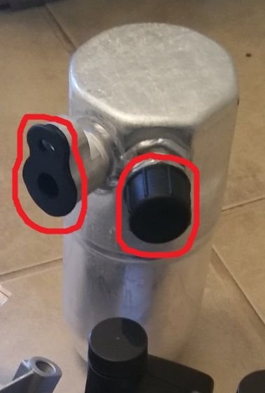

The accumulator contains a desiccant which removes any moisture in the coolant. You should replace it any time the system is opened. You should also ensure you ONLY pull the plugs and attach the lines to it right before you seal-up the system. You don't want it left open and absorbing moisture from the air.
Lionel, these are the plugs you're referring to?

YES! Those are the seal plugs that keep moisture/dirt out of the receiver/drier.
NOTE! Make SURE that you add the required OIL for the components replaced. Some COMPRESSORS come with oil some don't. MAKE SURE that you know what condition your compressor comes in OIL or NO OIL.
I usually add a little extra oil. What ever the system doesn't use, will be deposited in the receiver dryer.
