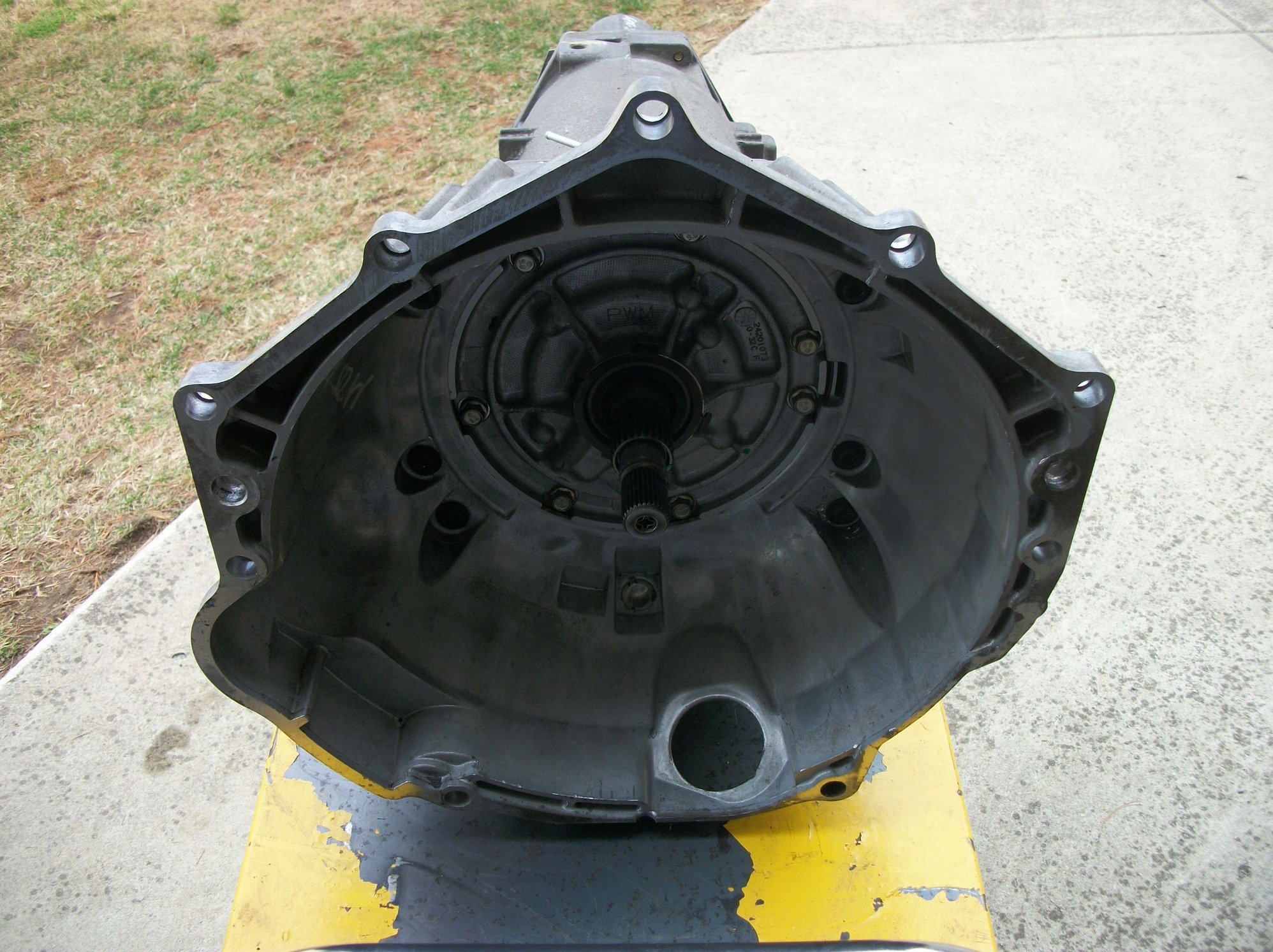

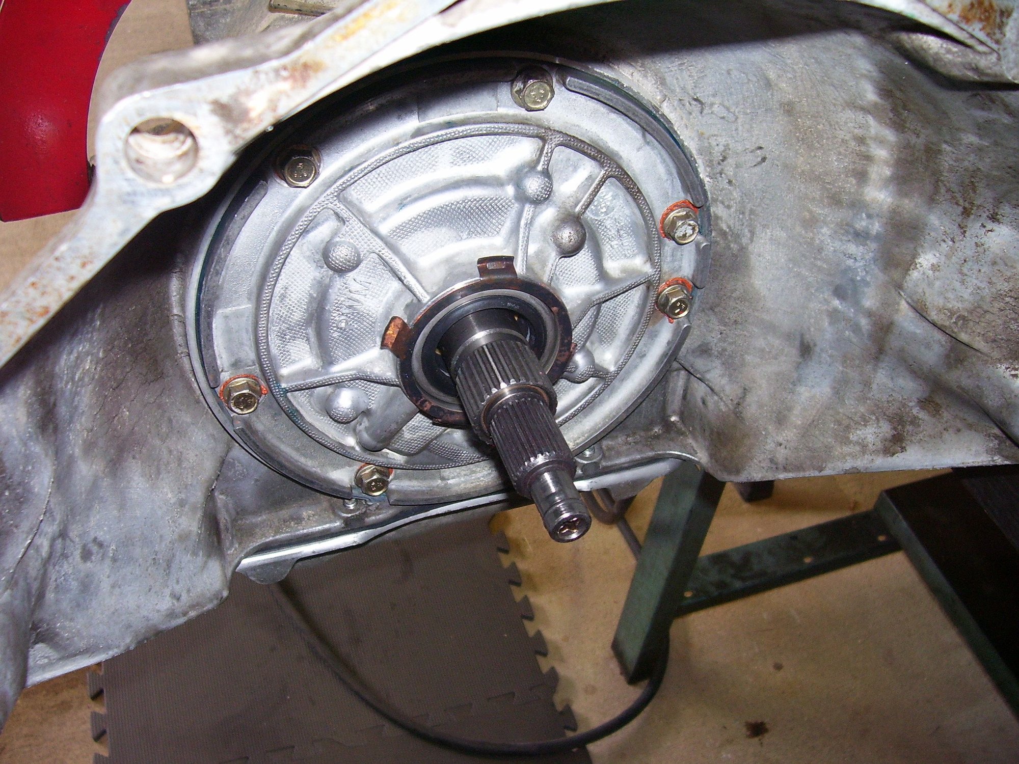

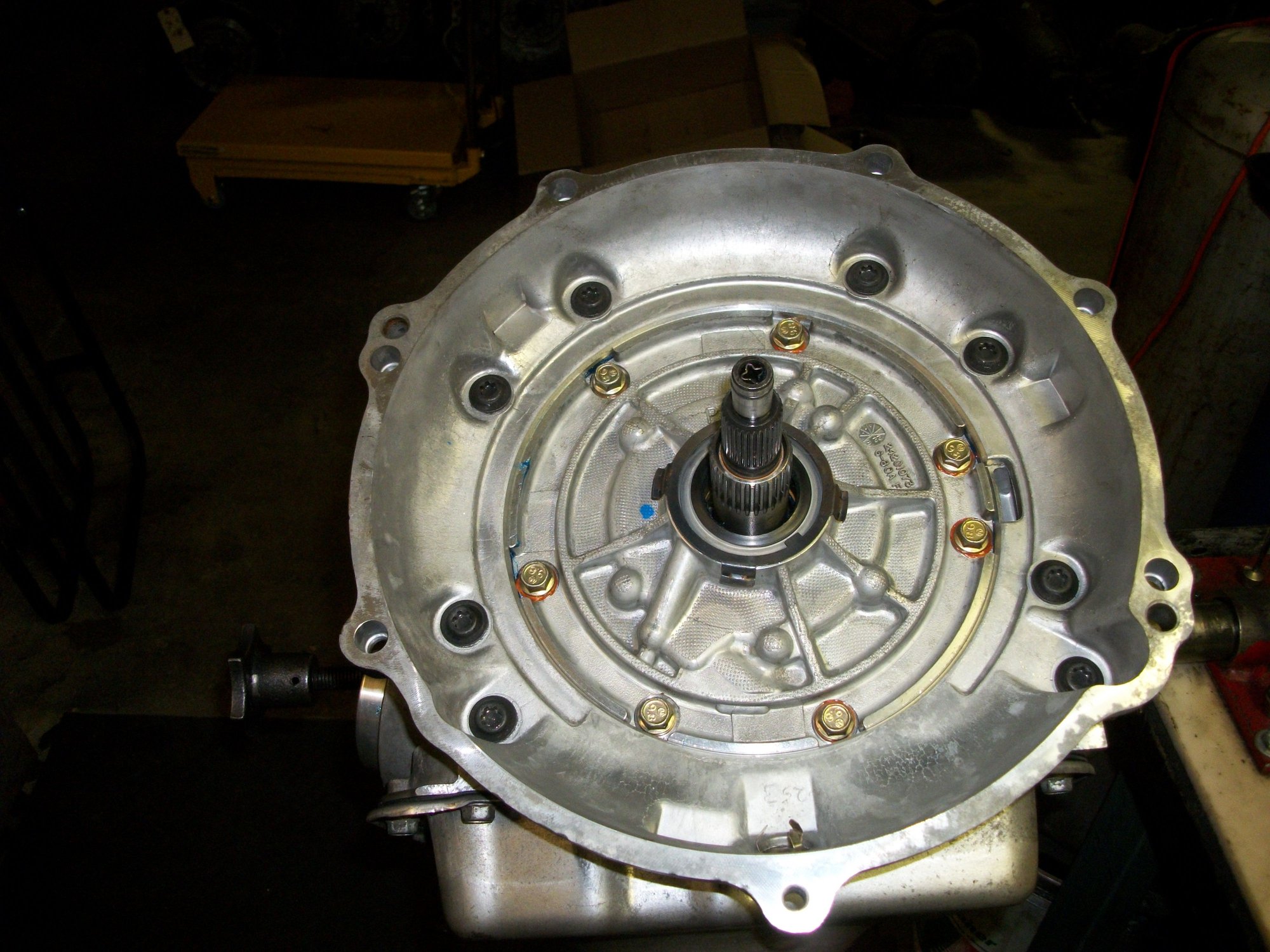

C5 Corvette 4L60E input shaft
Normal LS style 300 MM input shaft
LT style input shaft (Same as 87-93 700R4)
