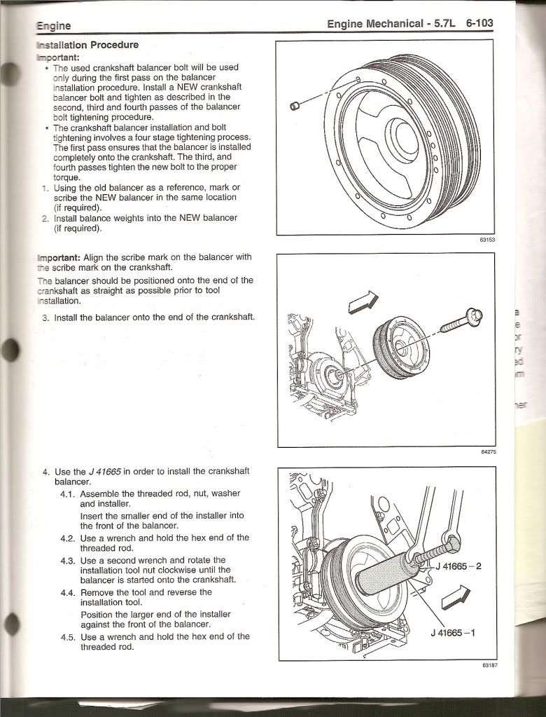

You are supposed to mark the orientation prior to removal. You are supposed to observe whether there are weights in the hb that require transfer to the new stock hb. How are you removing/installing? Don't follow ls1howto.com unless you want to damage the crankshaft. Here is the factory installation procedure.

Here is my dilemma. The balancer that was on there came apart and I do not know the way it was intended to be on there. I bought an acdelco replacement but it looks different from the one that was on there. What do you suggest as far as putting it back on correctly? Thank you for the help and all of the detail. I really appreciate it.

C5 DROPTOP99
Look at this picture. Where are the BALANCE PINS INSTALLED????? "On the OUTER RING"
Your outer ring is no longer on the HUB. You have ZERO way of knowing where it was when the factory finial balanced the engine.
You can SAVE the old outer ring and IF you have a balance issue
(I have never seen a damper replacement cause a balance issue)
You can knock out the balance pins out and insert them / It in one of the twelve HOLEs until the balance is regained.
If you look closely, you can see that the damper has TWO additional holes that was DRILLED at the finial balance.
Just install the new damper and enjoy.
