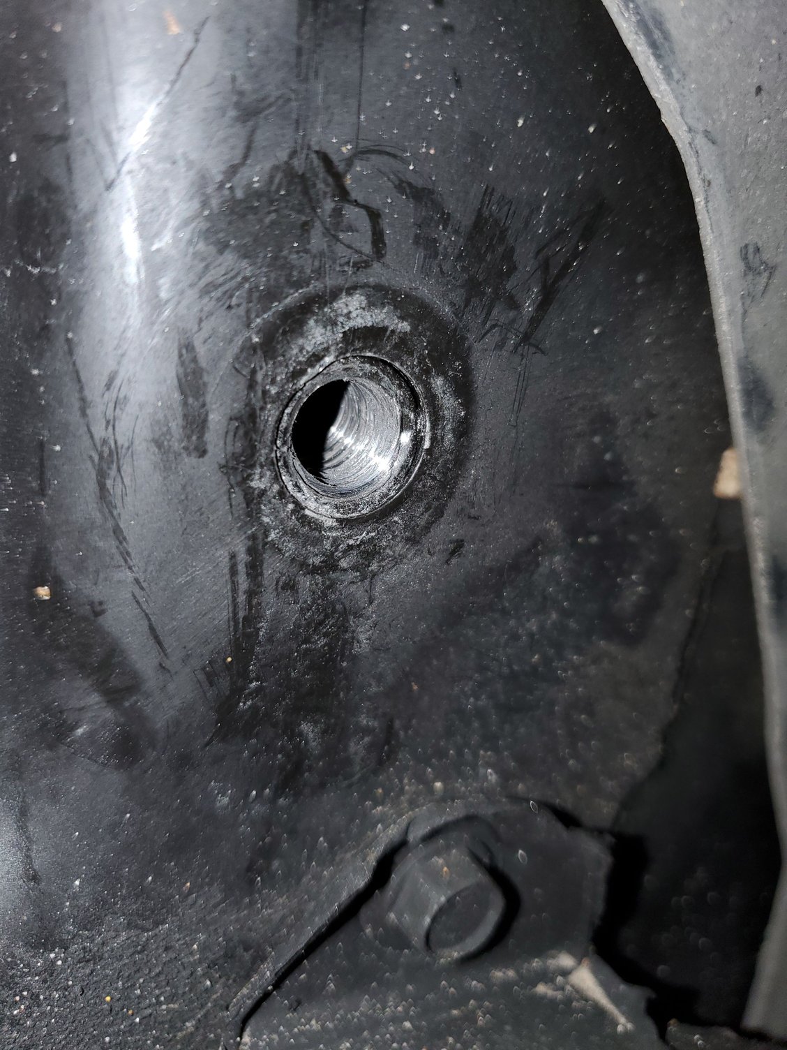

Bumping up an old thread.
I just went to install one of my upper control arms and one of the bolts does not want to hand tighten like the others.. not sure how this happened when removing. It doesn't appear TOO bad, just wanted to get yalls thoughts. Should I just try chasing with an M10x1.5 tool and hope that cleans it up enough??
thanks for any insight.
Pit the next size standard thread bolt in it(if it is metric), drill and tap it. I would put a stud in it If I use that a lot.
I'm sorry-When I first read your post, I misread it as being stripped. Yes, I would try chasing with the proper tap first, and use some oil, 3 in 1, or even motor oil. Don't remember the thread size. Maybe M12? You would have to measure the outside diameter of the bolt, then find out the pitch. The dealer would be able to provide bolt thread info, as a last resort. You may even be OK by just running the bolt in and out a few times, with some oil and a short wrench. It may be it is just going to be stiff from now on. Just don't cross thread it. How do the bolt threads look? If all fails, you may have to resort to a helicoil.
A helicoil would then be the best way to fix this. As a tool maker, I've installed hundreds of these in my career. Stripped threads are stronger with a helicoil repair than they were originally, provided there's enough surrounding material left to install one. In fact, AFR heads all come with helicoils in every thread. Had to laugh at an AFR competitor who used to advertise "our heads use no helicoils", which means they aren't as strong as a head WITH helicoils to those of us who really know. All helicoils I've ever used were stainless steel. If your rivet nut is not spinning, a helicoil would be preferred over an actual threaded insert. Why? Because usually a threaded insert needs to have the damaged thread drilled out larger than an actual helicoil, thereby weakening the surrounding metal more than a helicoil. Ask a buddy to borrow a helicoil kit, or get it yourself. A helicoil kit should be available at a good Hardware, or Big Box Store. Use some sort of cutting oil when drilling your damaged threads out for the helicoil tap. 3 in 1 oil, or even motor oil will do in a pinch. A good helicoil kit will have the actual inserts, the correct drill, the tap you'll need, a cranking tool to spin the insert down to the required depth, and a straight punch type piece of metal to break off the drive tang of the helicoil itself. Once you have the hole drilled, use a countersink, or some kind of chamfering tool to cut at least a 1/16" deep "lead", or angle. This is the step where most people screw up their job. If you don't provide a decent lead angle/chamfer for the helicoil start in, you'll be fighting it to get it started. It should come with some basic instructions, and it's really not as difficult to do as this may sound, or as some may say. Just take your time. I don't know the depth of helicoil you'll need, but I'd guess roughly 12mm. Personally, I'd keep the thread the same as original, i.e.-metric. By the way, here's a rule of thumb on metric threads; the pitch of a metric thread, when subtracted from the thread diameter, will equal the tap drill size needed to tap the threads. This formula has nothing to do with your helicoil issue. See below......
Say you have an M10×1.5 thread. Subtracting 1.5 from 10mm=8.5mm tap drill size.
An M8×1.25? 8mm-1.25mm=6.75mm tap drill. Works for almost any metric thread.......
Also, any SAE with a 16 thread per inch pitch can be drilled correctly by subtracting 1/16" from thread diameter. See below......
3/4"×16=3/4"-1/16=11/16, etc......
​​​​​Hope this helps the people who don't know.......
