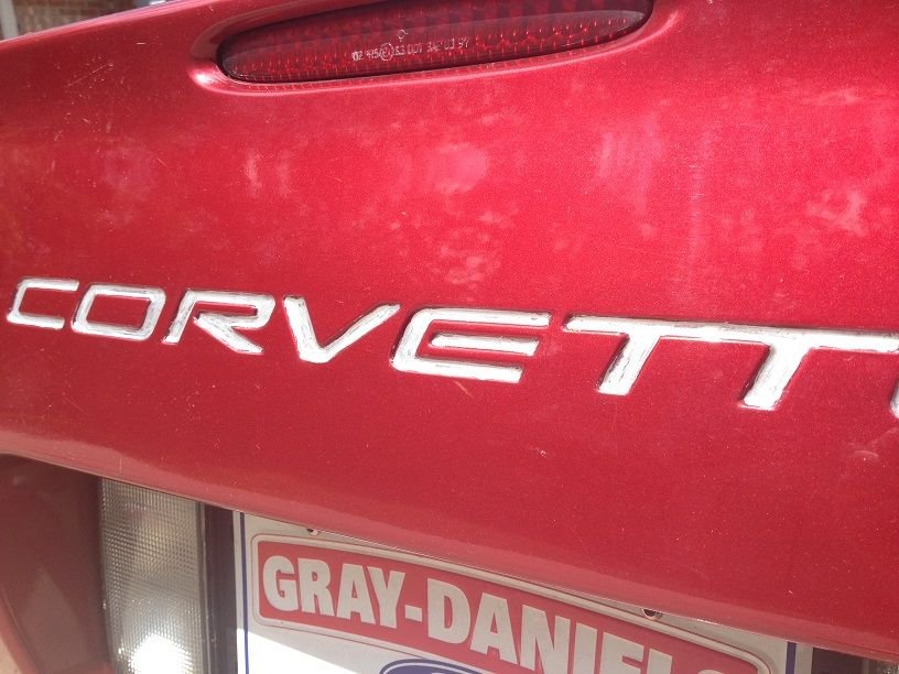

They are also gonna take care of this for me:
I thought it was decals but upon looking closer one of the previous owners hand painted the silver lettering. It looks horrible close up. It makes me wonder why people do such things.

One other option on the rear panel. They do make a stainless lettering kit that might cover up that poor paint job if you like the look of the silver lettering. They have other colors too. Not sure if that would save you any money but if you like the letters to be a contrasting color might be worth investigation.

Yes. Their plan is to try and clean up that paint as much as they can and I'm going with the stainless steel letters. I prefer it to look original but the body shop guys highly recommend putting something there after they clean up the paint.
