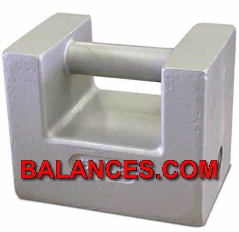

I'm a bit lucky, in a sense, because my late father was a district manager for the Toledo Scale Company, and he was able to obtain 4 of these scale "test weights". They weigh 50 pounds each, and are quite stable. He originally used them for "winter ballast", in the trunk of his cars. I now use them, set up on end, along with a short piece of 2x4 (or two) under the "jacking pucks".
