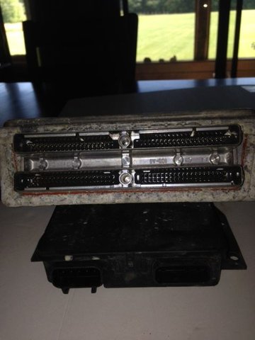

Connectors on PCM clean. Housing corroded
Housing corroded.
2001 Automatic 65000 miles. Hard start and Reduced Power Mode. Code 1518. I'm checking what may be the cause and thought I'd post some pics and ask a few questions. The PCM connectors were taped with electrical tape and I doubt if they came that way. I unwrapped one and it was clean and still had di-elec grease on it. Will check the rest later. The TPS connector wiring is short and has to make a sharp bend. The harness is connected with snaps (factory) by the fuel rail so there isn't way to add length.?? Is this short harness factory or will the TPS attach in a different position? The PCM case is corroded but the connectors themselves are in good shape. The TC Module visibly looks okay. I checked the maintenance records from Chevy garage (previous owner) and the TPS was changed at 19000 + miles and again at 39000+ miles. I suspect this is the cause of the 1518 code and reduced power. I'll be changing the TPS in a few days and will let you know if it corrects the problem.

Cleaned and reinstalled all the computer PCM/TCM and connectors and applied some di-elec grease. The connectors were pretty clean. There was a nut plate and screw missing on the access panel that left a hole where water and debris was coming through. Engine started right up and let it run for awhile while running RPM up. No reduce power. I have a TPS coming in Monday. I'll drive it and keep new TPS in the car in case the gremlin is hiding and waiting to strand me. Will post update.

Removed the tape covering these connectors. Did see some slight moisture inside. Only one had a tiny film of Di- Elec grease. Guessing it was grease. Question: Are the ends of these connectors open like this direct from factory? A few weeks ago we did run into some two hours of heavy rain coming out of Canada. Will put some grease on them but I'll let them dry out overnight. If there suppose to be a cover over them I'll have to come up with something besides tape. Any suggestions welcome.
