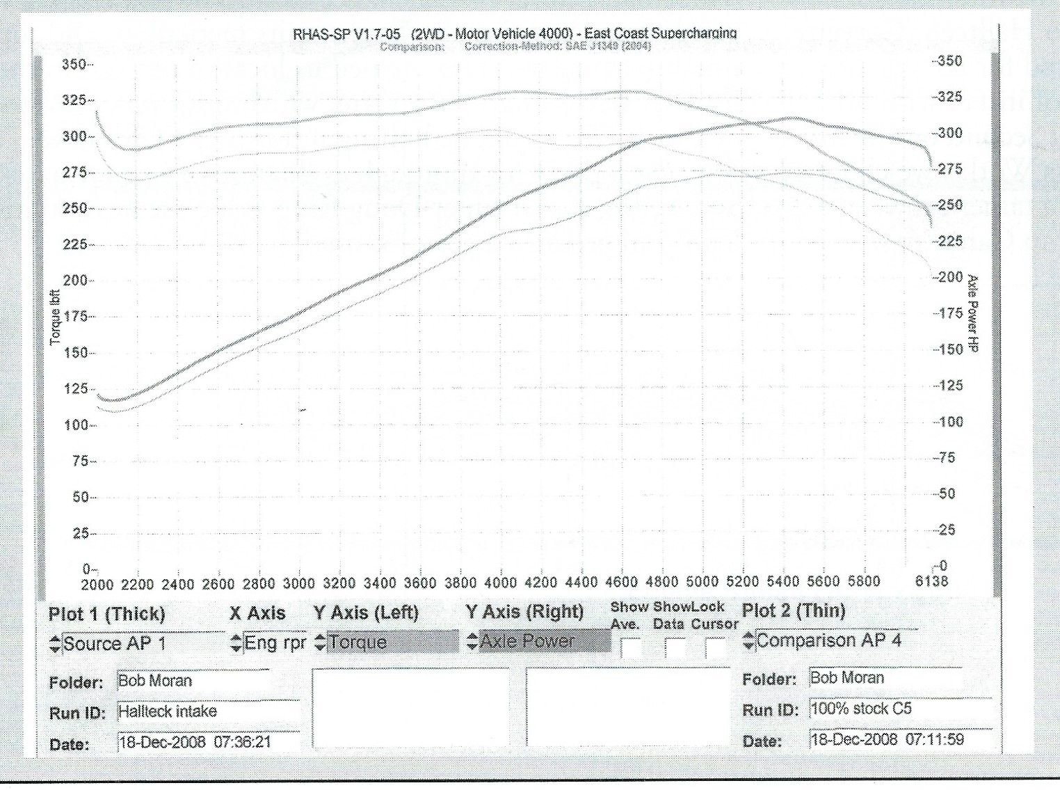

Here is a scan of before and after dyno tests of a stock C5 (before) and with the only modification being a Halltech C5 Venom cold air intake installed.
Done by East Coast Supercharging on December 18, 2008.
And the reported results, from page 132 of HP Books, CHEVY LS BUILDUPS copywright 2011:
A gain of 36.5 HP and 23.4 FT-LB.

Hot damn! Do we have comparable info on the vararam/calloway?

BS...gee wonder why Gm missed that one lol
what may look good in theory many times translates to zero in real life.
Wont gain 40hp from an X pipe or plug wires either come on...no easy way, rules havent changed

Yes a stock c5 6sp will show about 305-310 rwhp. The best way to show less hp on a stock intake is to have a dirty filter. Also, was a cooling fan used during the test, it will also give different results. It would have been better to show the differences in IAT for a valid comparison.
