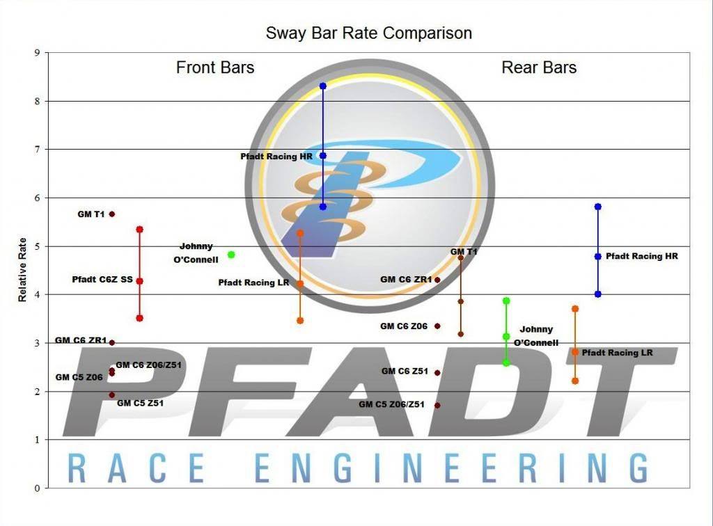

A few years ago after a lot of track testing Aaron Pfadt of Pfadt Race Engineering said this about the rear sway bar: “Even if you’re not looking to do a major suspension change, consider at least replacing your stock rear sway with the rear sway from the Z51. The Z51 rear sway has about half the rate of the stock Z06 sway. We feel this set up is better balanced. This setup might be slower for the Nurburgring but it will be better for autocross events.”
His input would make me believe nothing more substantial than a C6 Z51 rear sway bar is what you need for a street car. If you really want to start tracking it you may want to look at the coil overs Bill Curlee suggested, as well as an adjustable rear sway bar matched to a comparable front sway. Several of our vendors could help you with very competitive suspension set ups. Just remember the old racing adage: "Speed costs money, how fast do you want to go?"

Those components shold be fairly optimal. I'm assuming you have metal end links. If you're looking for a big step up from what you have, coil overs is your best bet.
Now if you want to fine tune to your driving style and comfort zone here's a general rule. If the car is rolling too much you need stiff bars all around. If the car is flat enough for you but you're having understeer then a stiffer bar will help. However stiffer rears are less forgiving and can cause over steer. Like wise if the back end comes around too easily then a lighter rear sway bar will help. Here's a graph from pfadt with the relative rates of common sways.

I like the graph above, also what do you think of how the car feels now? any over steer or under steer?
http://store.uucmotorwerks.com/artic...ybar_setup.htm
To tag along with the post above, look at how the rear rear swaybars are stiffer relative to the front for the widebody C6s. How large you want to go is a personal preference thing with the ride stiffness you find acceptable and what feels like over or under steer to you.
