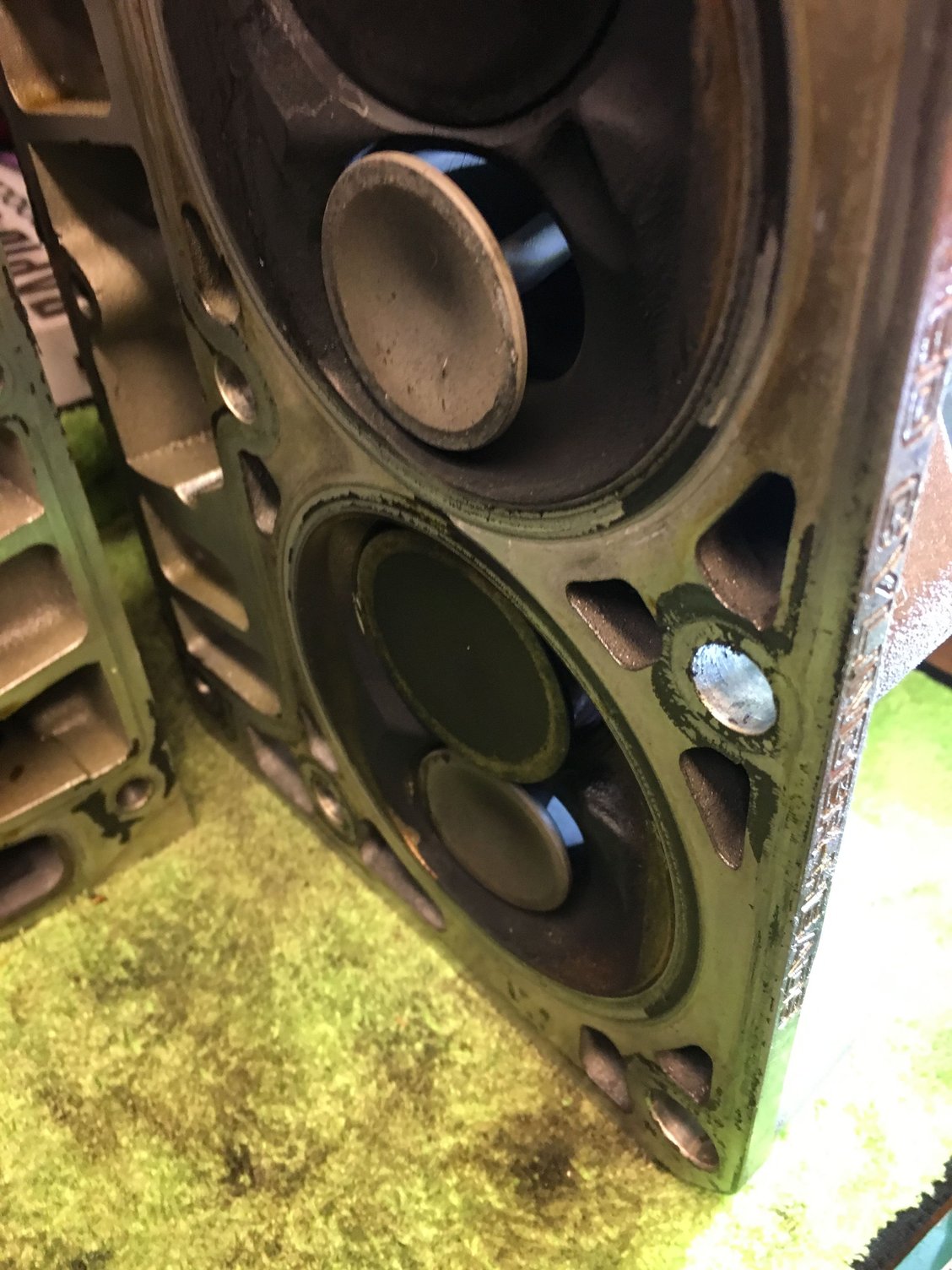

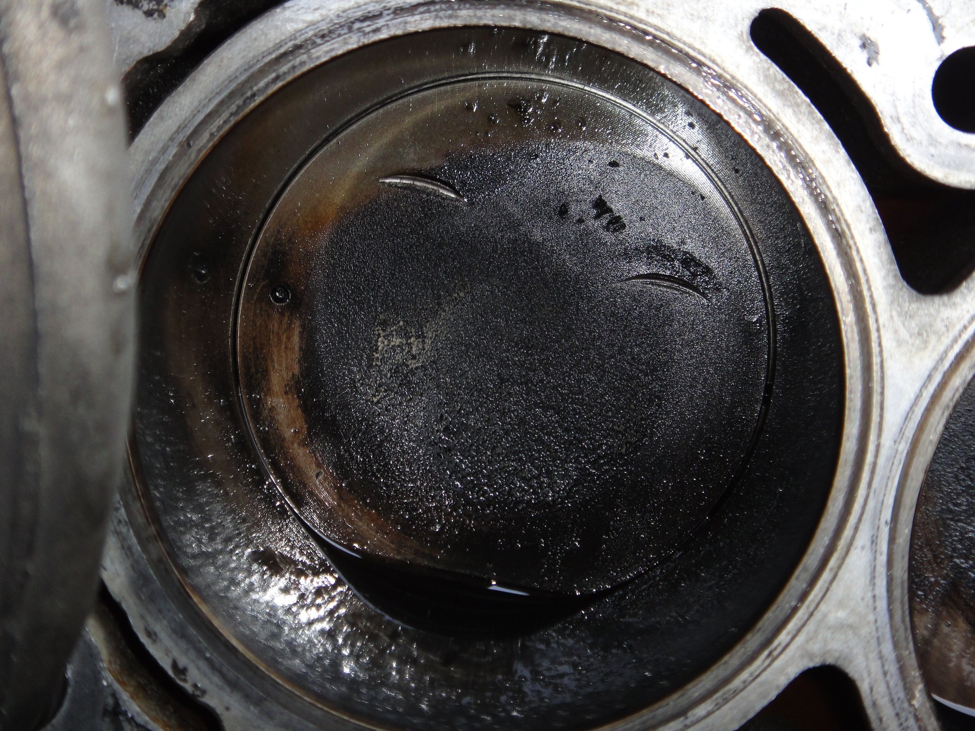

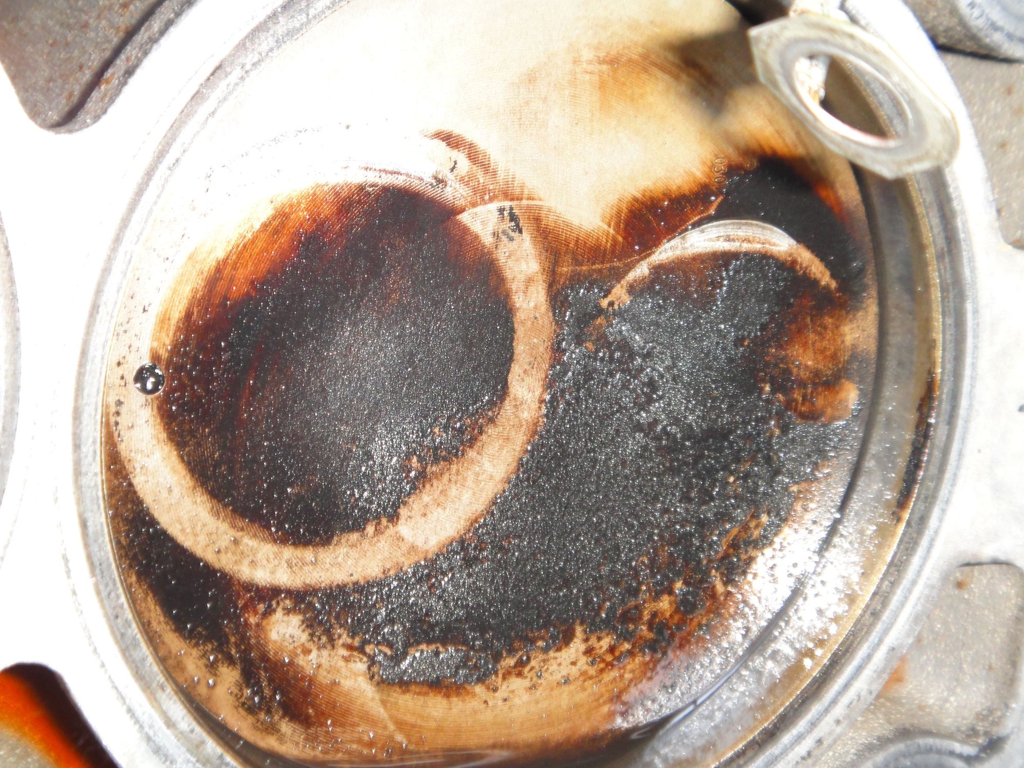

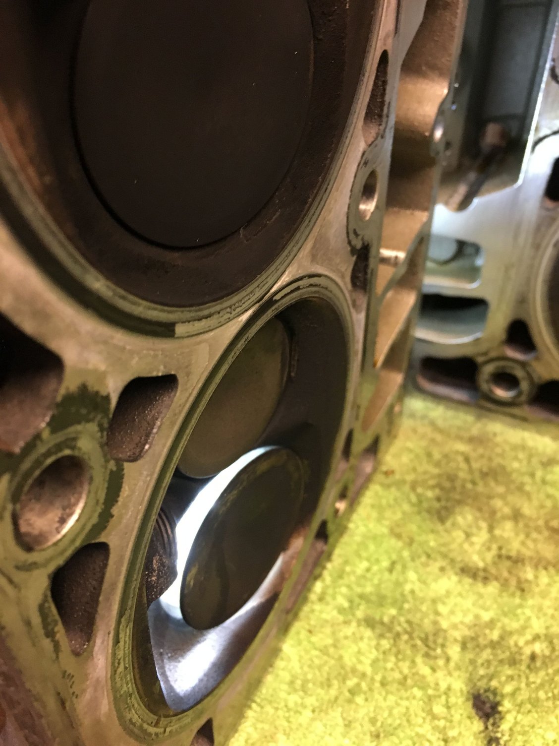

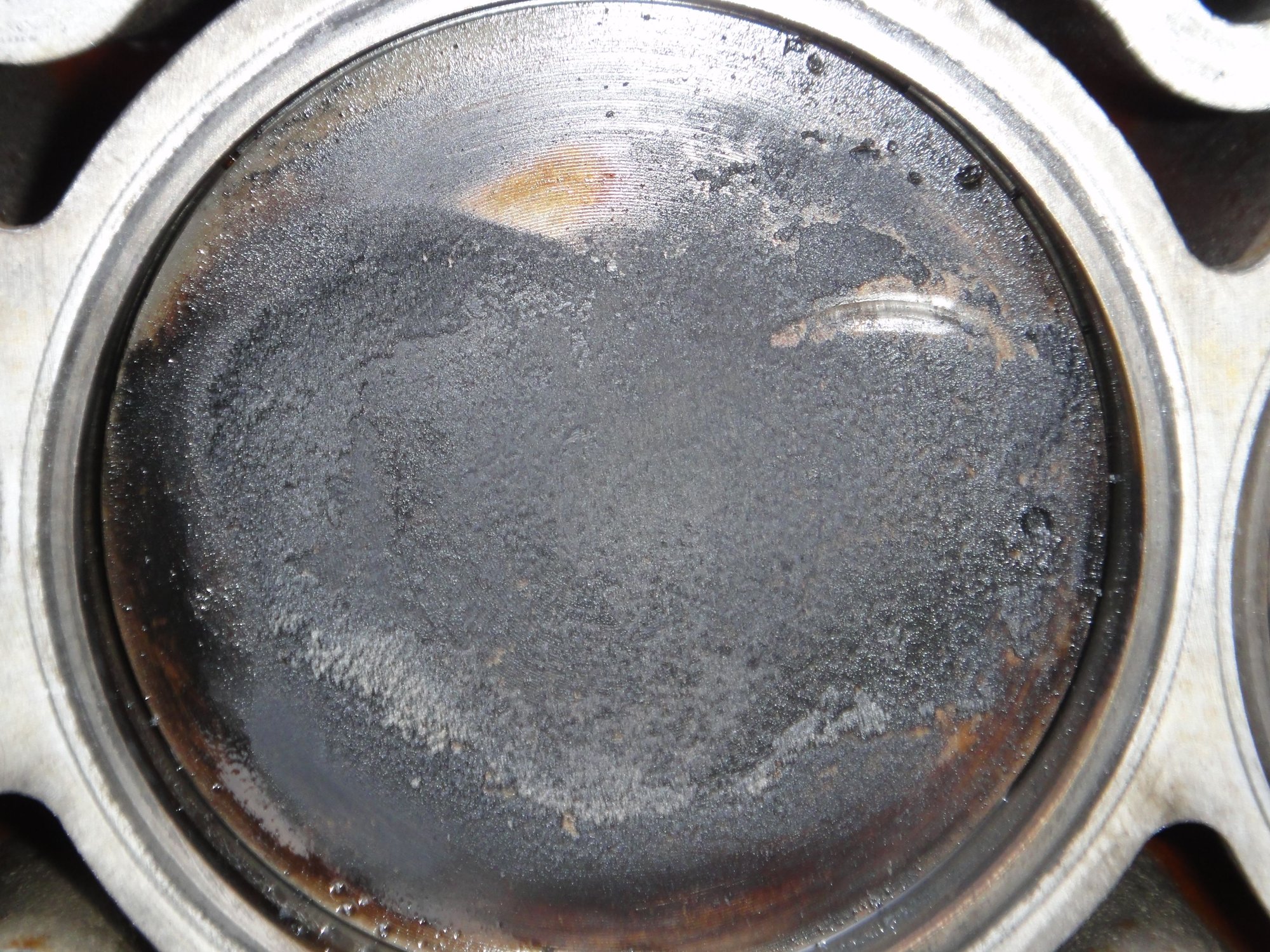

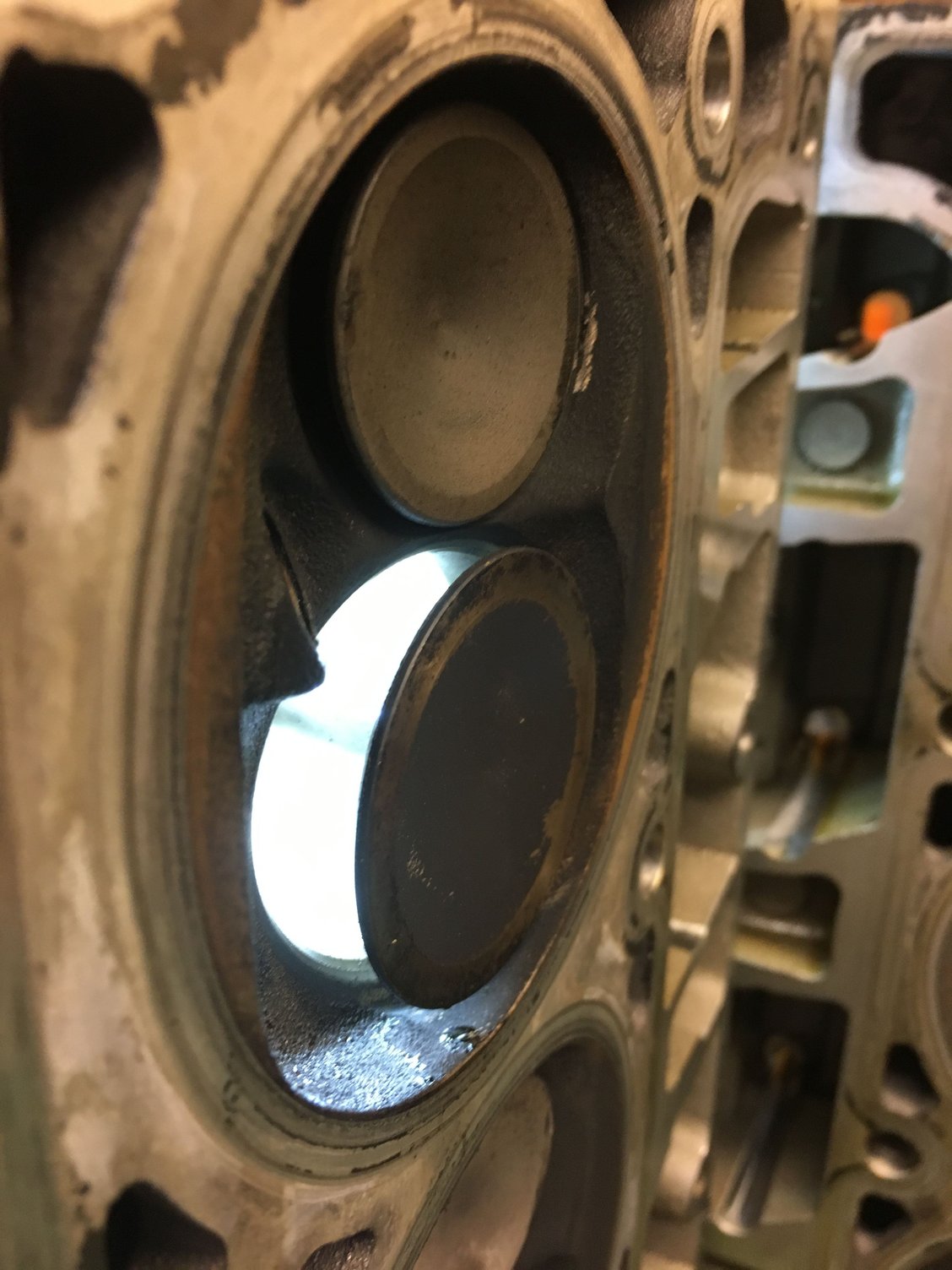

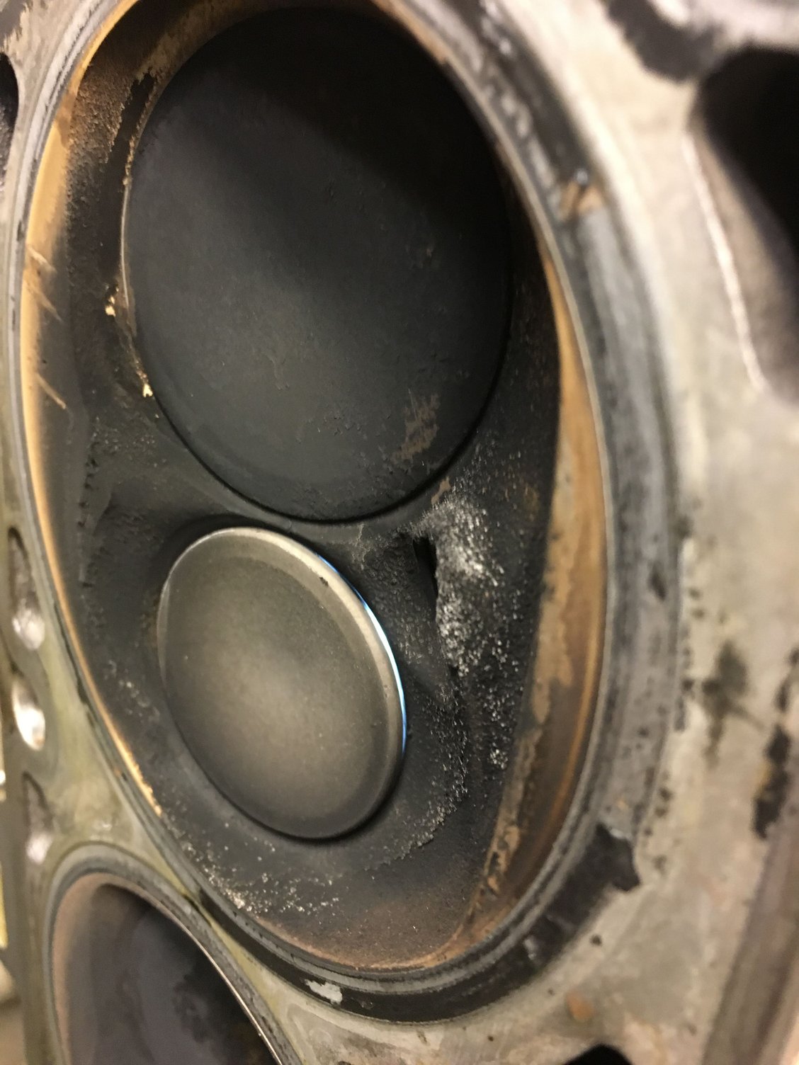

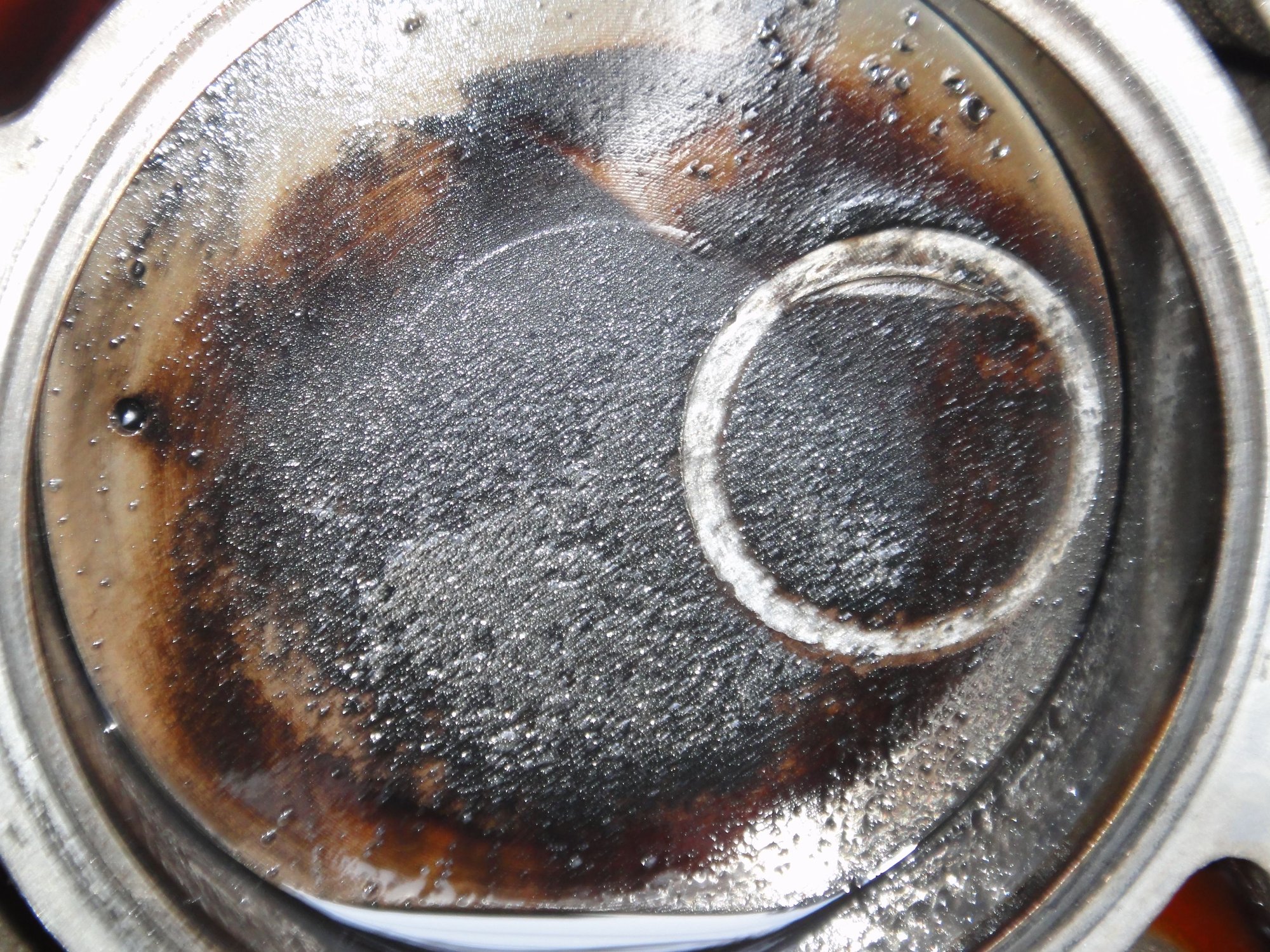

EDIT: Pulled the heads from what I can see 7 valves are bent, a few pistons have some lips stick from where the valves kissed not sure if there still good? haven't ripped the timing cover off at this point, pics was taken after a wd40'd the cylinders will update once i get to the timing chain....

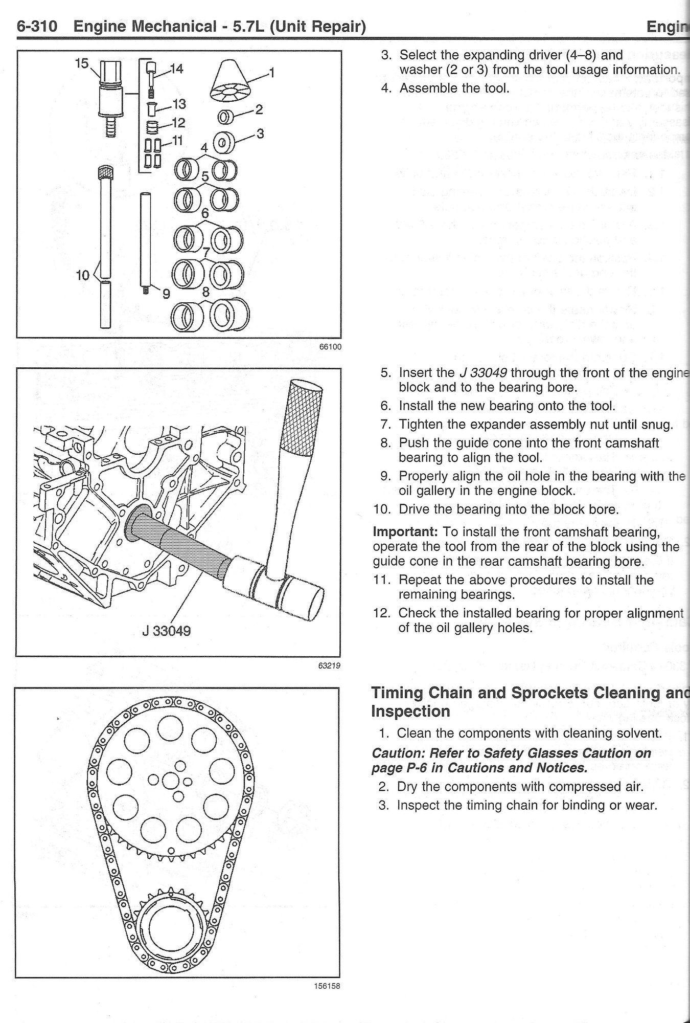

Not hard, but best to buy the correct Kent-Moore tool from ebay.

your talking about the "J-41558 Crankshaft Sprocket Remover" ? hate to spend $90 on a tool that i probably wont use more then 1 time, if the gears are in good shape and the c5r chain is a good replacement i might just go that route if not it is what it is

You WILL have bent valves!! Better start planning on at least ALL the exhaust and the pushrods. TRUST me o that one..
Remove the heads. Pour solvent in the head combuston chamber. If the solvent keaks out, BENT VALVES! You can look in the intake and exhaust runners and see what leaked!

Unless you have ZO6 Sodium filled exhaust valves, the valves are pretty tough and usually dont break. The sodium filled exhaust valves usually break off.
The pistons (if the valves dont break) will have small smiley Faces on them but not really any damage. Just buff off the area, look for any high spots, sand FLAT and keep on keeping on!!!
AGAIN,,, Make SURE the pushrods are not bent!

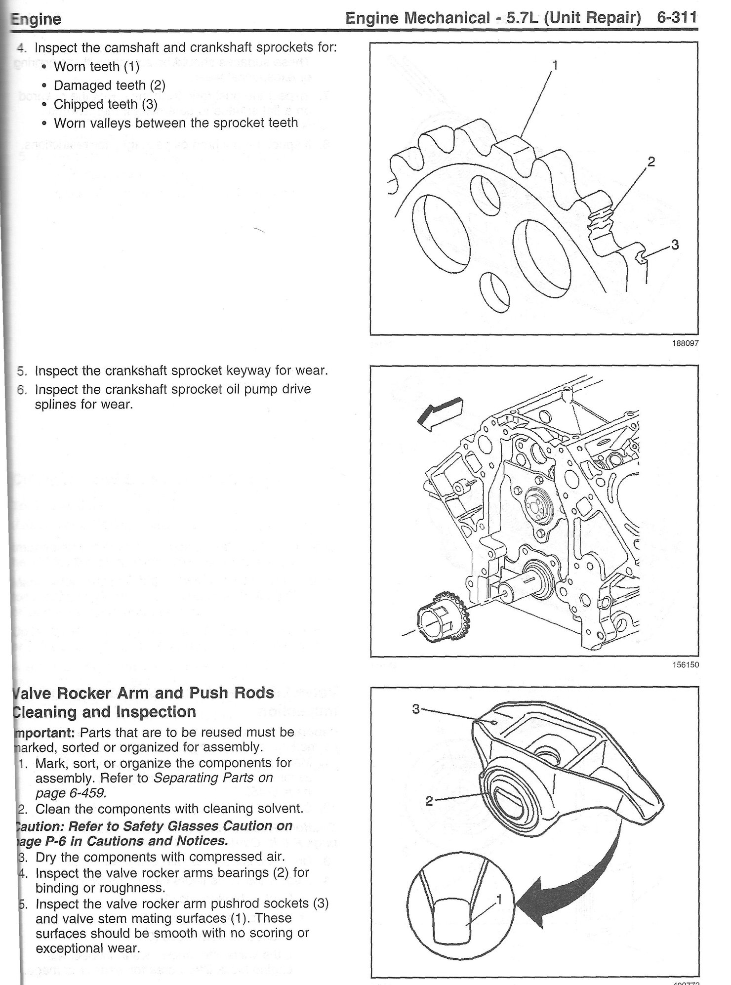

If you reuse the old timing chain sprockets, make sure to do an inspection per the service manual.
