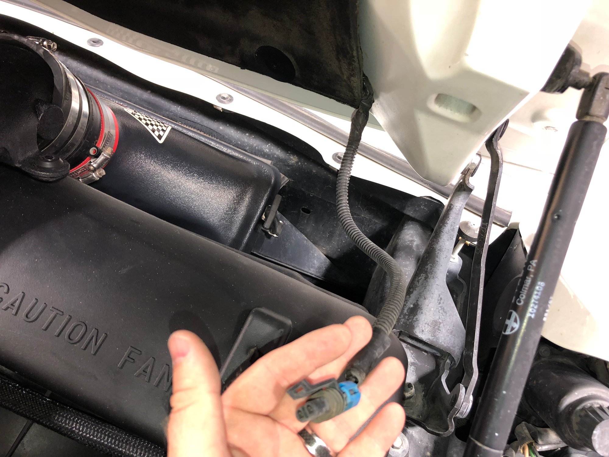

This steel braided line is located just under the brake reservoir and is zip-tied to the brake lines. Any idea what it goes to?
on a side note, the electrical line going to the hood is also disconnected, and I can’t seem to find the other end it plugs into.

So after a bit of research, I think it’s the clutch bleeder line. Can anyone confirm?

I would say yes it's probably a speed bleeder line.

Clutch bleeder, that's where I routed mine to as well.

That plug looks like it is for the under hood light. Probably got unplugged doing the cold air intake.
Yes, it is. Any idea where it plugs into?
