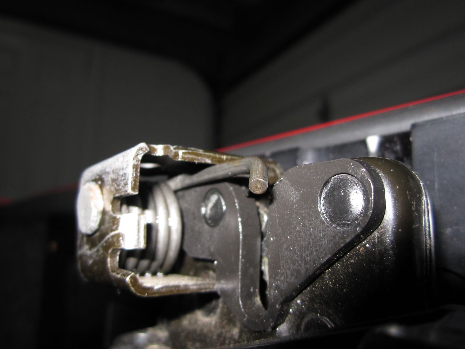

There's a spring on the latch that is supposed to be strong enough to lift the trunk lid about an inch when the solenoid is actuated because the gas springs don't do much at the closed angle.
Here's the spring and latch with the cover removed and the trunk open:
Check the spring to make sure it isn't broken or too weak to be in the position shown. The old original grease in the latch becomes dirty and dries up causing the parts to bind. Try cleaning the latch assembly with solvent and apply new grease such as Mobil 1 to the moving parts. It's a good idea to do the same with the parking brake handle assembly and hood latches since the grease in those is almost two decades old as well.
