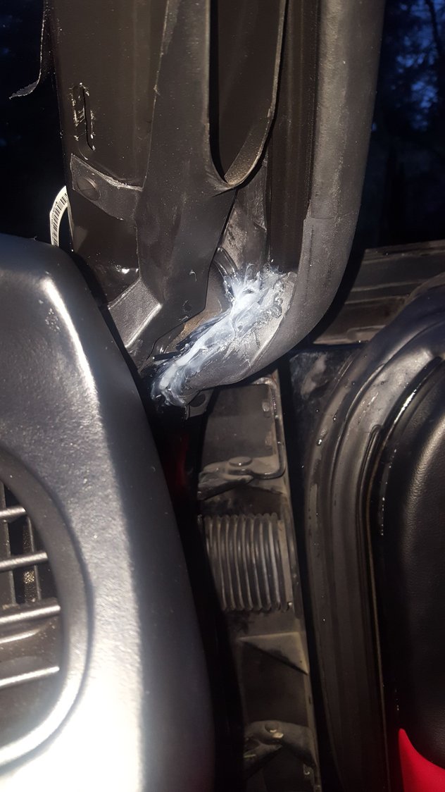

Thanks for the reply Bill, I've read your posts religiously since I bought this thing, they're a godsend tbh. I got the lock issue figured out, it was a bad connection it seems, and I smacked the window motor a few times and jarred it loose finally. The leak is coming in from the A pillar below the vent. I did my best to seal it up with some glazing silicone (pic below), so I'll see how it does tonight when it inevitably pours down rain. The more I read on these frcs/z06s, the more I learn that they have some serious electrical/leak issues. A few of the engineers at GM deserve a good a$$ whooping.
