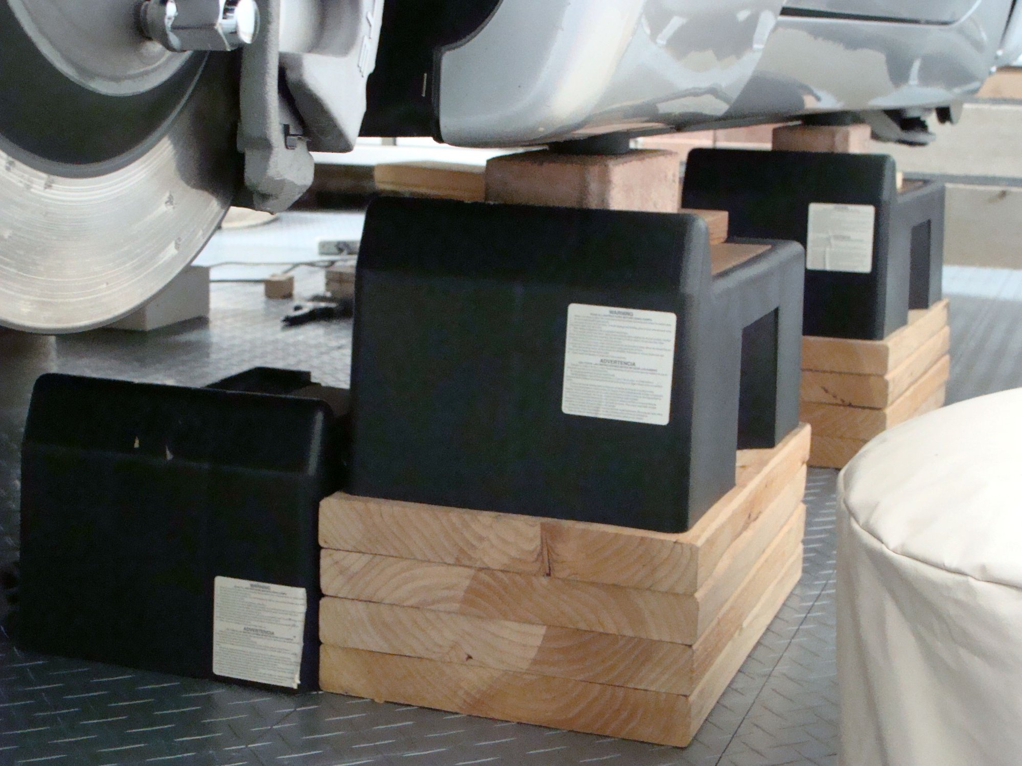

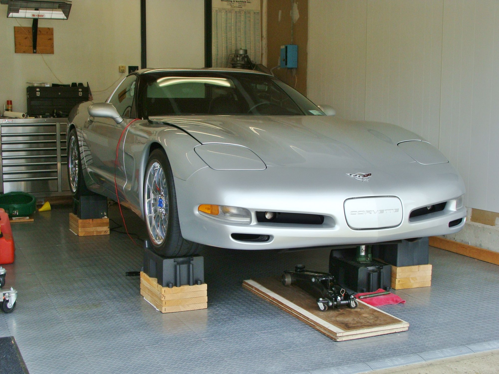

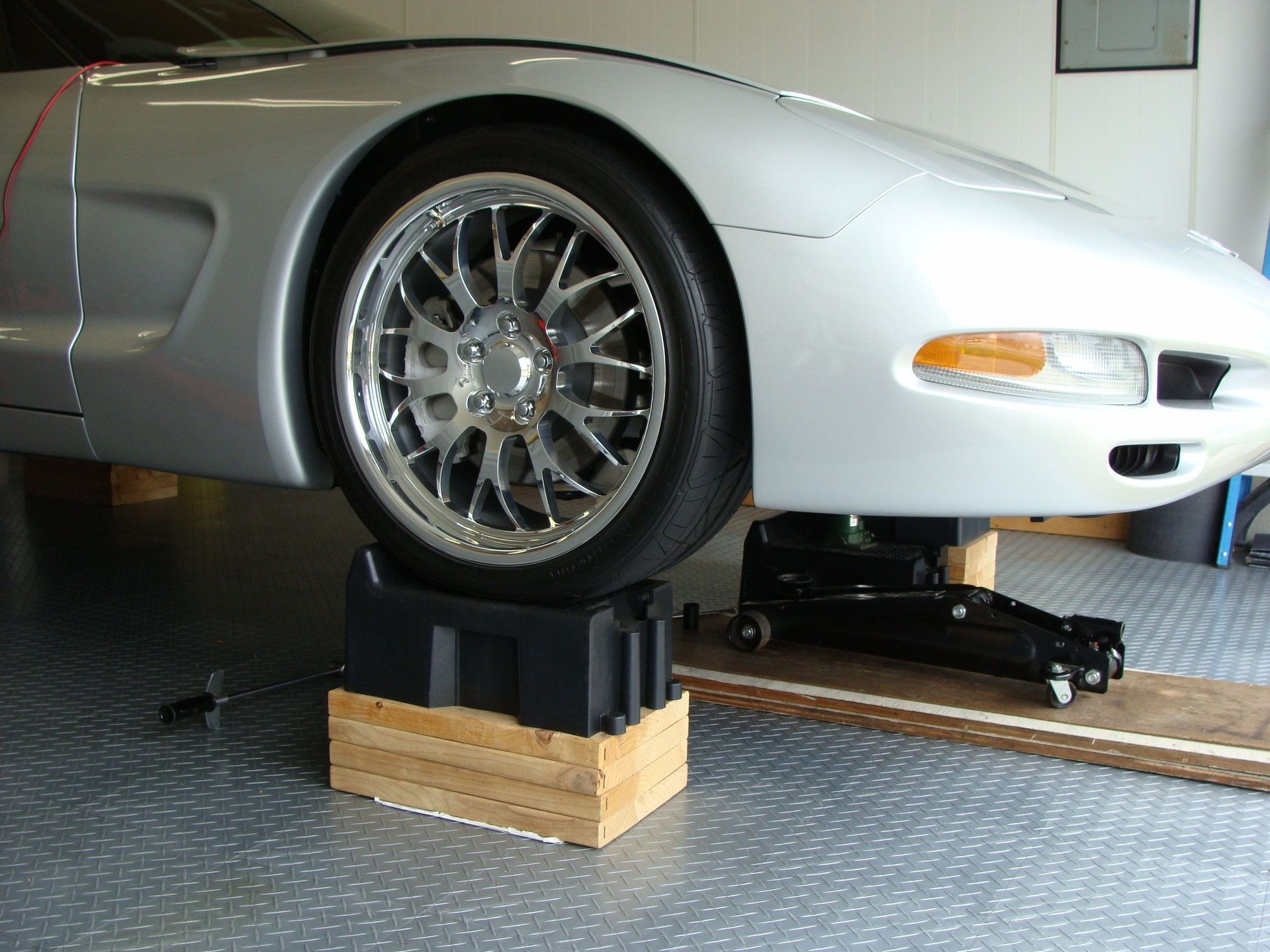

Old Jul 4, 2018 | 03:16 PM
6speedsteve's Avatar
6speedsteve
Joined: Dec 2010
Posts: 1,776
Likes: 500
From: West Seneca NY
Just for ideas, the total height is 13" with the plastic ramps, all of the sections are locked together so nothing can slide, under the ramps are blocks that the ramps slide over, the wood blocks have bolts in 2 opposing corners and the blocks & different length bolts can be added or removed to change the height. The ramps you can flip the raised stops different ways so when jacking the car does not roll forward or backwards when jacking.
You could build taller blocks to set the car on the jacking points.
If I were using jack stands, I have a set that are 24" tall, I would have to make a steel u channel cap that fits over the top of the stand & locks into the jacking point just to be safer.
I have wooden blocks that fit under each cradle that also have blocking to hold them in place when jacking, my jack maxes out at 20" so I have to add height at the floor to get car on top of the ramps with suspension at full droop.
Never had any mishaps so it's all about safety, don't cut corners.

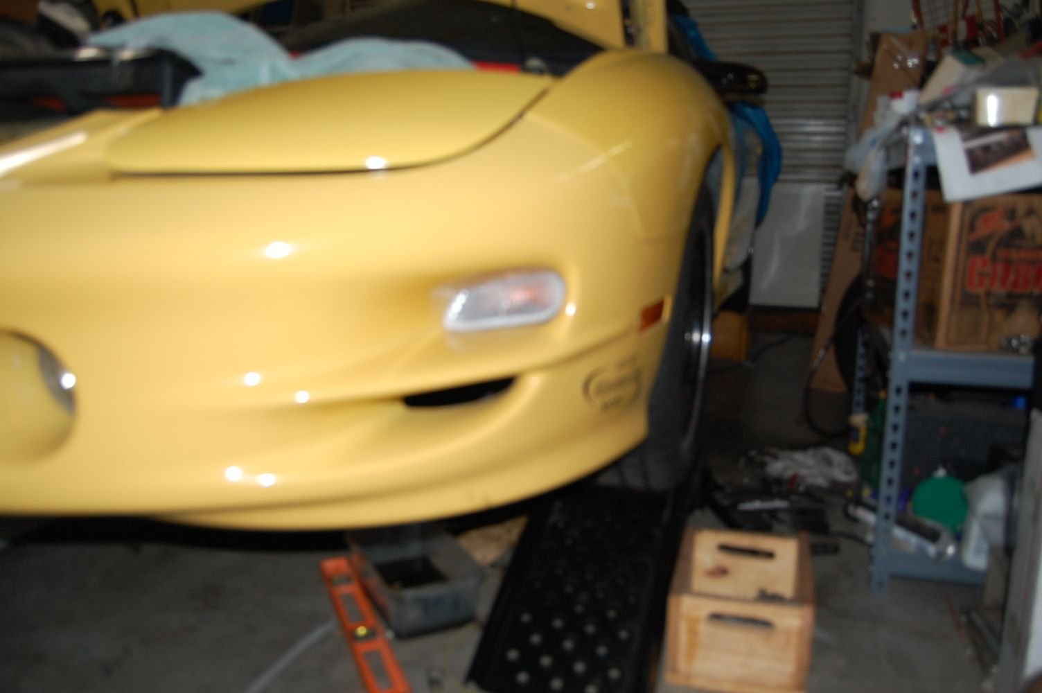

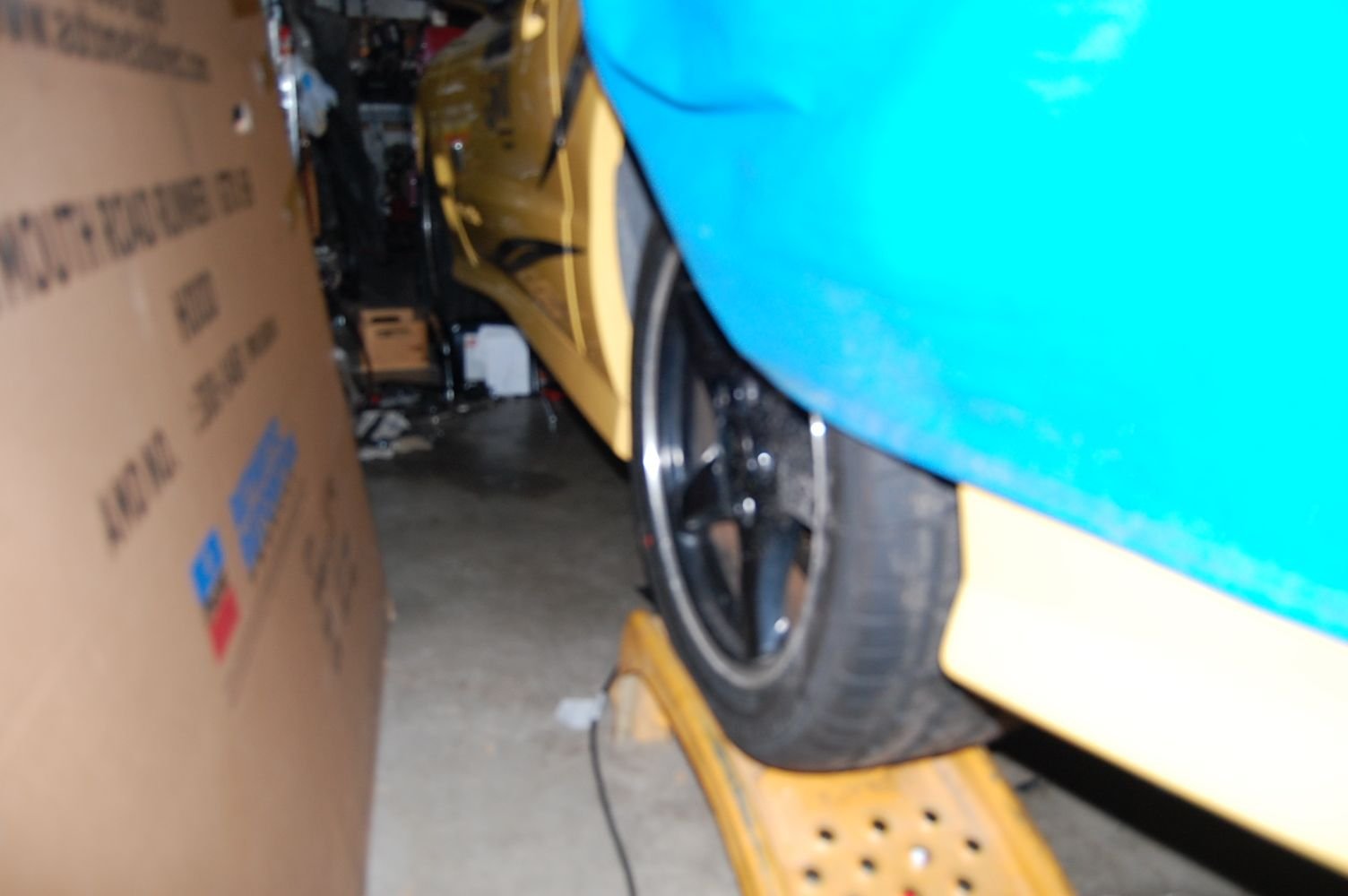

Default Lift
6speedsteve,
Thats what I am thinking. How did you move the supports inward? Here is my transam on metal ramps. Plenty of room to remove tranny and I am huge.
Old Jul 4, 2018 | 10:16 PM
6speedsteve
Joined: Dec 2010
Posts: 1,776
Likes: 500
Originally Posted by johnfin
6speedsteve,
Not sure what you mean by moving the supports inward?
