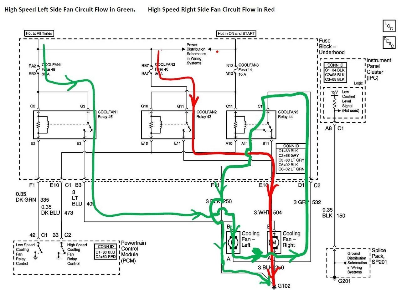

Originally Posted by 8VETTE7
If the fans are not going into high speed the problem is MOST likely with one of the relays or one of the fuses. You first need to know that BOTH fans are running in low speed mode.
This link shows the electrical flow of the fans in both low speed and high speed mode. Note the relays 43 and 44 and fuse 46 and 14 as they are critical components of the fans operating in high speed mode.
https://www.corvetteforum.com/forums...post1597580437
Definitely check all the things suggested in the post by runner140*
ok so looking at the photo in that thread (attached above) it looks like during normal operation relay 45 controls both fans. when high speed fans are needed relay 44 closes and goes to ground so 45 is only controlling the left side fan then relay 43 engages the right side fan. This all makes perfect sense to me since in normal conditions both fans are drawing from the same circuit so they are splitting the 12 volts between the 2 fans then in high speed once 44 closes and goes to ground that puts all 12 volts to just the left fan then 43 supplies 12 volts to the right fan. This is all crystal clear to me. and typically when the fans are running at high speed you can hear those things blowing some air. now here is where I get completely stumped. I have sac city corvettes coolit in my car which replaces relay 43 and allows you to energize relay 43 at will and should supply 12 volts to the right side fan on command. While my engine is nice and cool so neither fan is running I energized the right fan with the coolit. it sounded like the fan was running in low speed mode! looking at the above diagrams that should not even be possible! before I replaced the fans you could hear the right side fan kick on in high speed now with new fans in the car it sounds like it is running at low speed! I am stumped!
