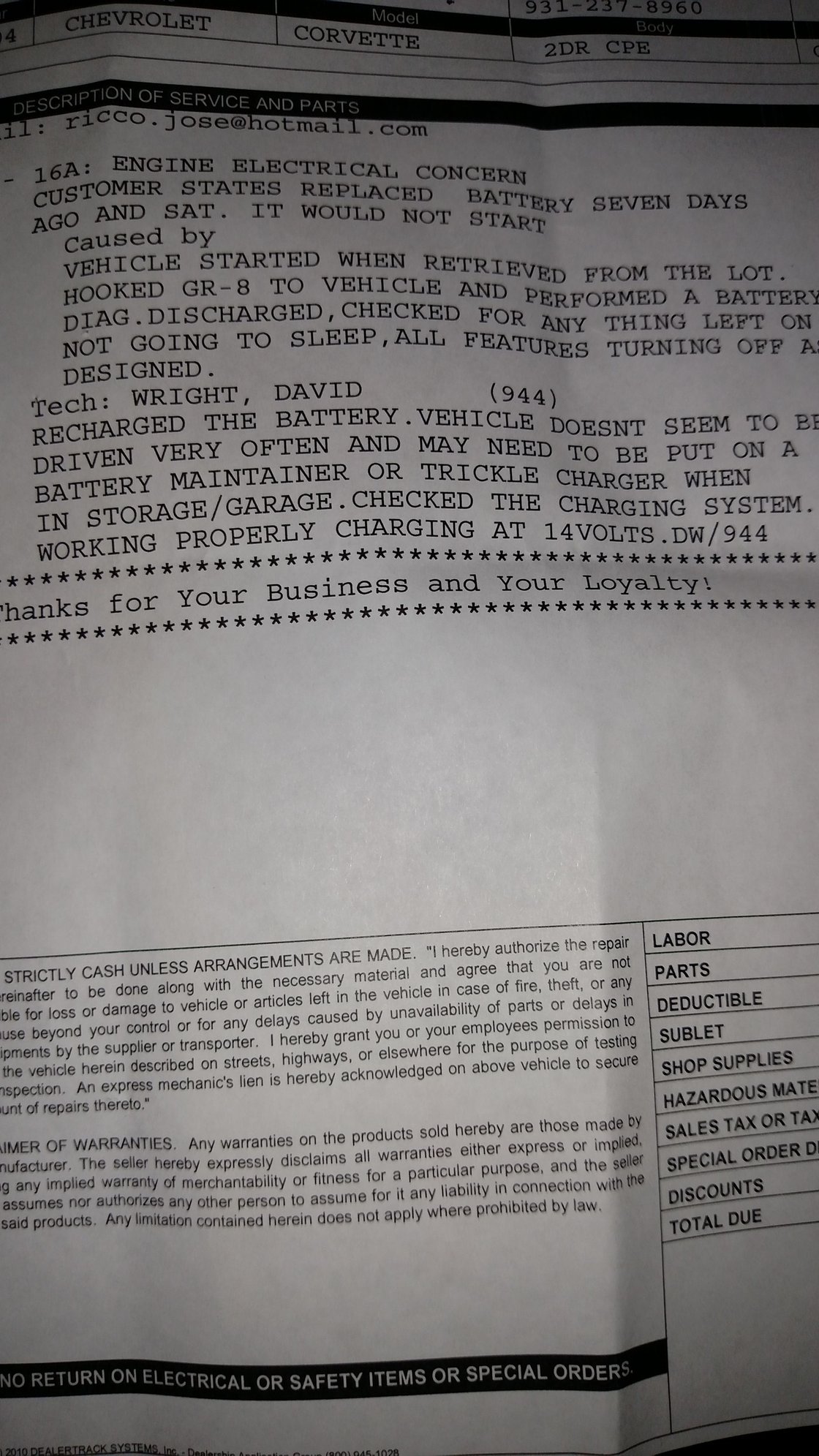

Default Dealer response
the dealership couldn't find anything wrong, wasn't charged for anything, I guess I should keep a trickle charger on it, just didn't make any sense to me, why brand new battery would go dead in 6 days after purchase, but I do appreciate everyone's input!
It's warming up! Drive it a little more!

Dude, your battery should NOT be dead in 6 days PERIOD...end of story...take it to a good shop in your area...how about Clarksville Automotive Engine Repair...see Lou !!

My car can sit for an easy 30 days and the battery will still crank the engine. You should have 20 milliamps for sleep current draw when the car is off and resting.
You SHOULD also have a battery with the CORRECT reserve capacity! If I remember correctly, it 120 RC. Its tough to find a 120 RC battery that doesn't cost an arm and a leg. 110 RC will work fine.
