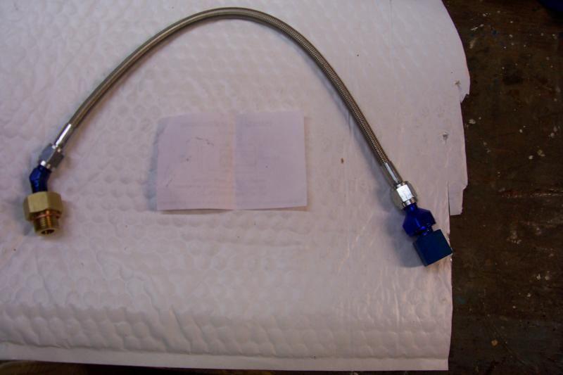

You mentioned that you dont want to do this job again.... Not that it was a bad job but I felt the same and wanted to do it once. This is why I put the oil sender relocate kit in, now if it fails, 5 minutes.
I got all the parts from Summit

Thanks for the sheet I ordered the parts and will be installing it, how did you address the wiring connector and where do you have it located after the modification

You will need thread sealer or plumbers tape for all fittings (I used a good quality thread sealer)
if you run the new new location by the drivers side firewall or where I located it, drivers side fuel rail cover, the harness reaches with no problem. You can use a few tie wraps to secure it in place.
