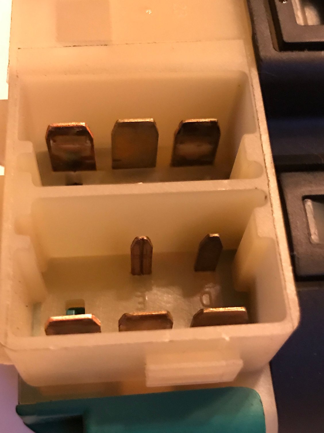

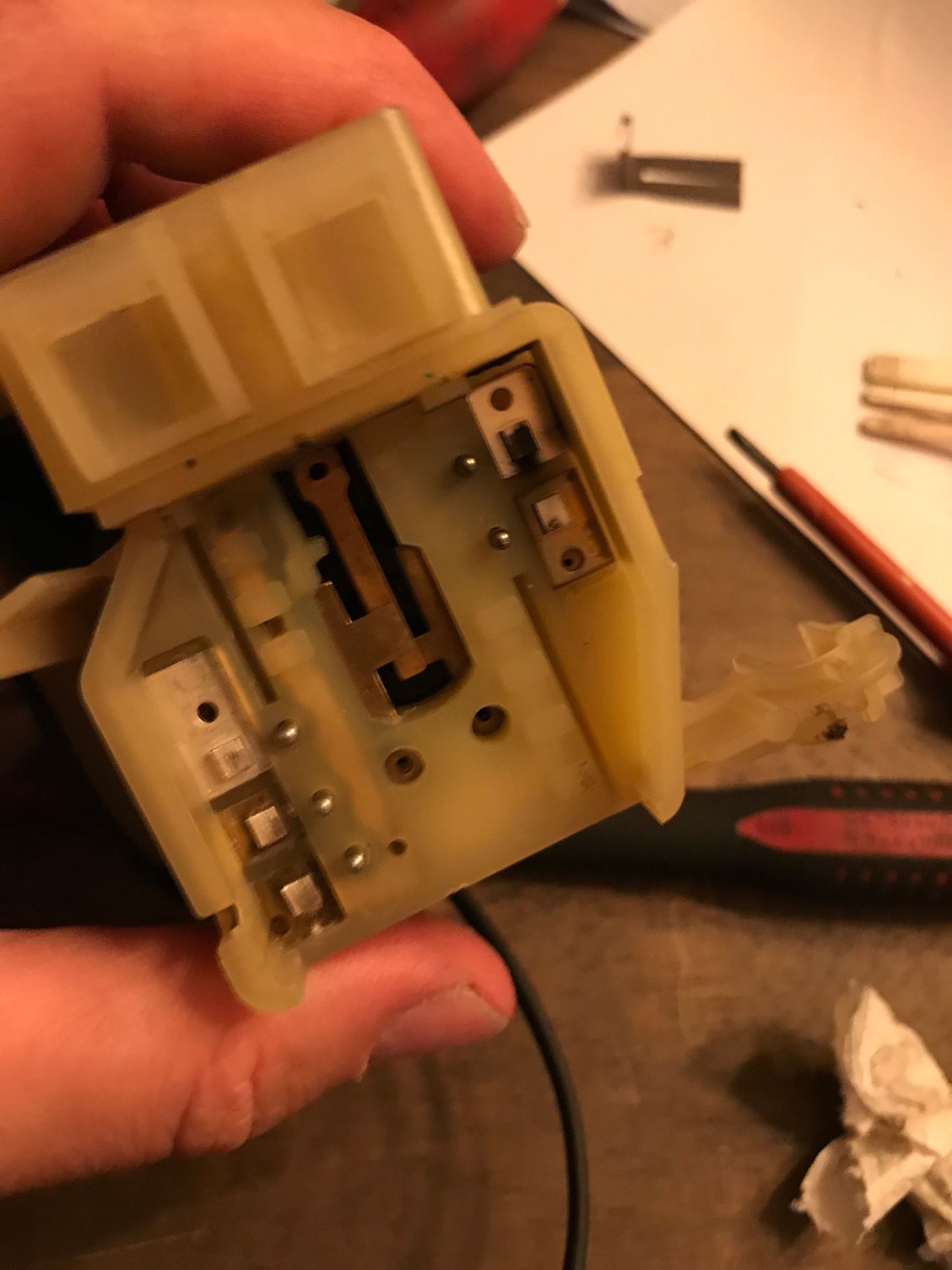

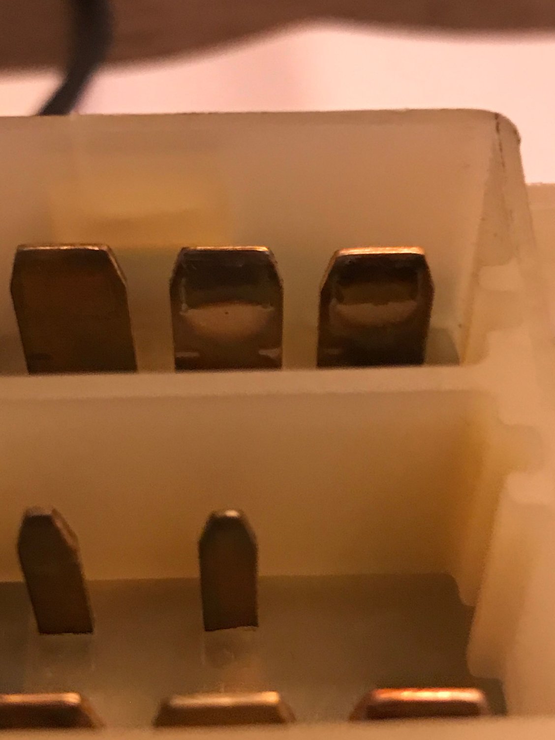

An update.
I disassembled the key shift and as you said it was full of coat. Really black and messy.
Here is is some pics
I cleaned it up (first I did an mistake. I opened where the key cylinder was and all the pins and springs jumped out lol. Lucky I got them right back again.)
now it it runs perfect and no messages. (Hope it stays like that)
Really thanks for the help. And it was the most logical fault.
