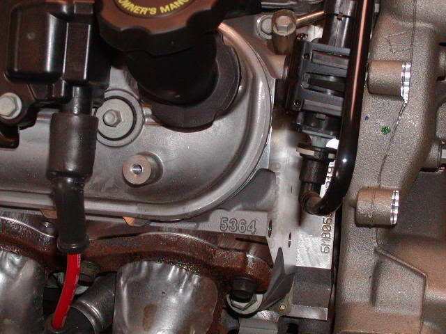

Then Id agree, seems like a waste at this point on stock heads.
You should have 241's but you can check on the front passenger corner of the head near the oil fill. Should be a 3 digit casting number, 4 in this example but you get the idea.
