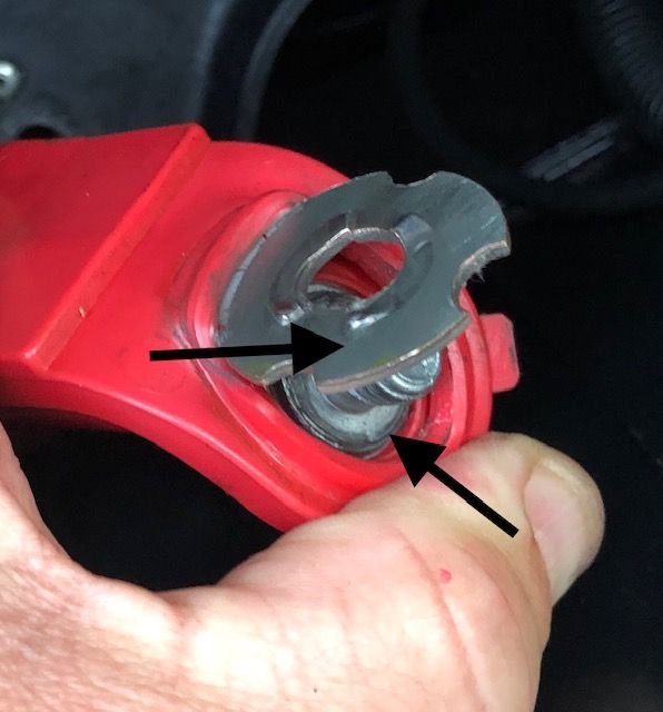

Solenoid's can have bad spots, inside the insulator of the solenoid is a big copper washer that is pushed against the terminal where the battery cables are connected and the terminal which sends power to the starter motor itself. Copper is vaporized every time the starter is energized and sometimes that contact is made at the same place on the copper washer.
