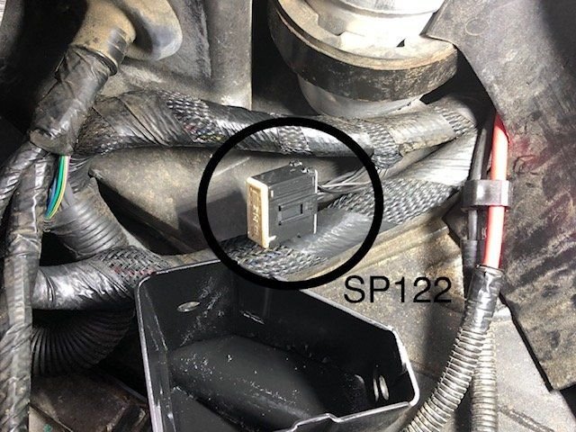

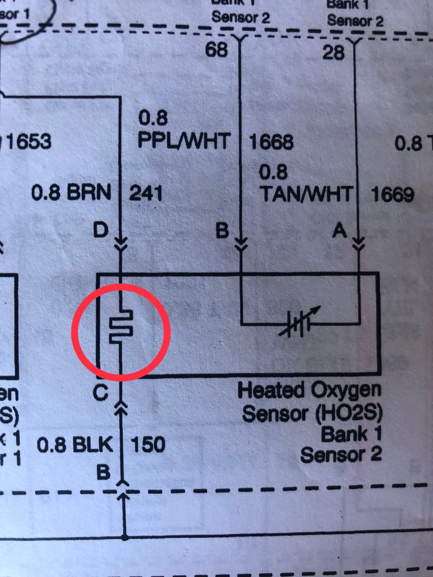

You should have 3.5-14 ohms (coming from my service manual) on a cold sensor probing the same color wires at the sensor. The BROWN wire is power feed harness side and BLACK wire is a body ground...it goes to splice pack 122 (SP122) shown with battery and tray removed which is located at the back of the battery tray...remove the top of the SP by squeezing the ends of it and remove the “comb” and make sure there is no corrosion inside (comb shown removed)...from SP 122 it goes to a body ground ...with your voltmeter you can connect red lead to power wire (BROWN) and black lead to the black wire harness side (GROUND) and see if you read battery voltage...if good voltage you know the ground is good..if voltage low or 0 you have a bad ground...try that for now !’

NO...the splice pack is GROUND... Easiest thing is connect voltmeter to BROWN and BLACK on harness side...if voltage is the same as your battery voltage the ground is GOOD !!...if voltage is much
lower now you have to check for corrosion at the splice pack...all 4 O2 heater grounds go through this splice pack to a ground at the left engine block by the front O2 sensor...I use old headlight bulbs of different AMP ratings to “LOAD” the ground circuit depending on the circuit...my front O2 heater draws 1.556 AMPS at idle... if a 1.5 amp headlight bulb doesn’t light brightly when connected across the 2 wires I know I have ground issues !!
