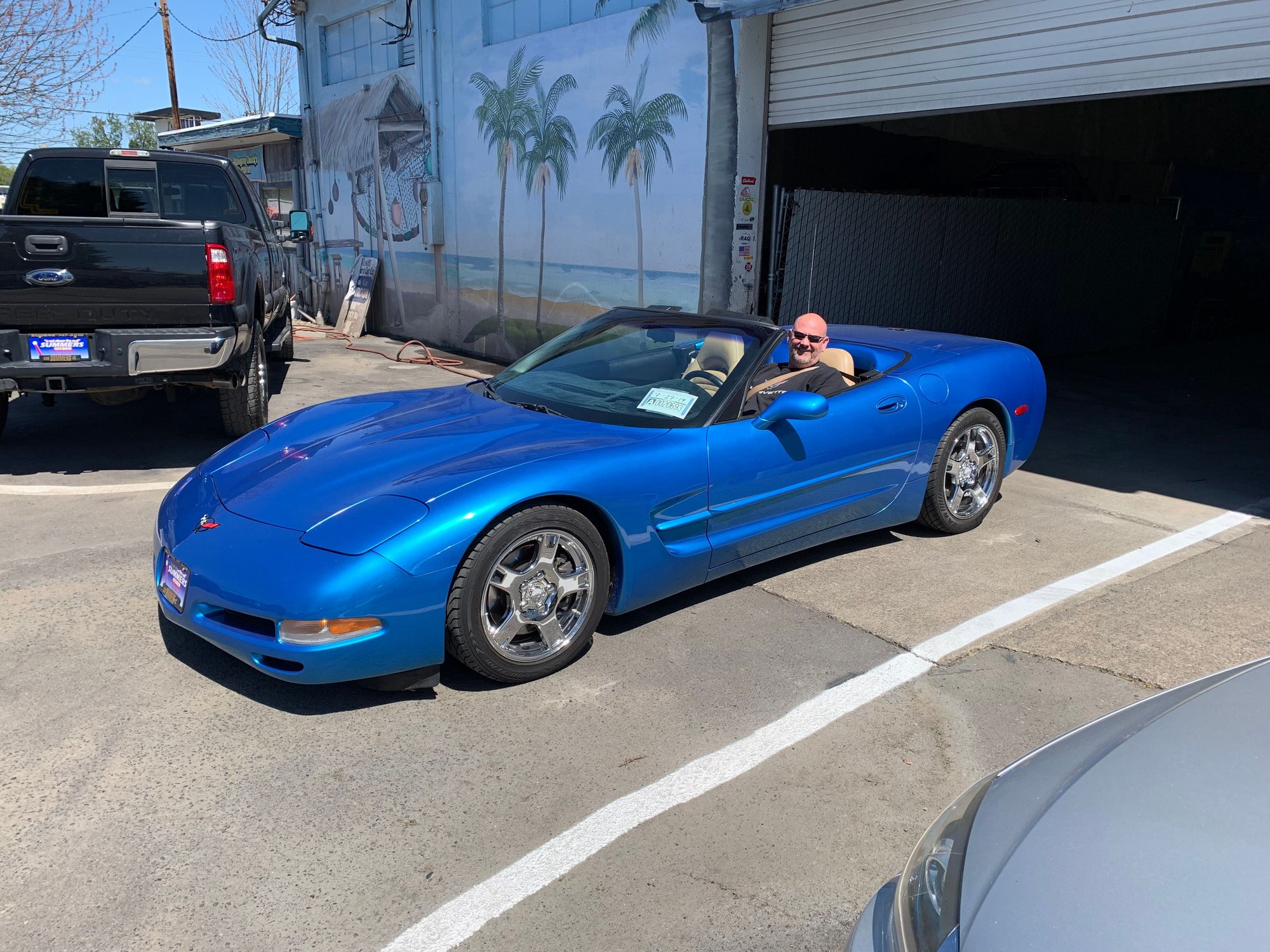

Hey everyone!
I have a 99, Nassau Blue Convertible. Only upgrade so far is a K&N air filter.
So I was on my way to meet the club to go to a cars and coffee at 0530 this morning when I looked at my heads up and saw the oil pressure maxed! Well, not knowing at the time about the C5 oil sensor, needless to say I became a little puckered! I pulled off and got on the forums and quickly found that I was not looking at my worst fears! Seeing that I had been sidelined too long I returned home and went to a local show. I am also noticing a small amount of oil coming out of my right muffler, out of the muffler seam and not the tail pipe. This happened after a recent oil change, first since buying it, and not sure the prior owner used Mobil one.
My question is, what should I upgrade why I am taking the intake and everything apart?
I am not looking to do heads and exhaust just yet, which I am pretty sure I will be going the trick flow top end route, but am looking more for possibly intake, throttle and so forth. Any other sensors I should replace why I’m at it? Those sort of things. Oh and not looking to do anything crazy like nitrous.
thanks for any direction you can lend!
