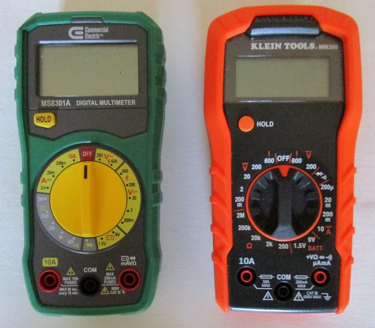

Here are the two meters that I bought that gave their lives in vain when trying to find a parasitic drain. Both had blown the internal fuse.
As you can see the one on the left says "max 30 sec. every 15 min." for the 10A plug.
After they had passed I found a similar warning in the instruction sheet about not using the meter at more than 2A for more than 2 minutes.
I have had previous experience with Chinese products that have had fuses that blew below their rating. Perhaps this was the case here?
I searched some online tutorials that searched for parasitic drains to see what specific multimeters they were using and most priced out at a minimum of $250. They were all rated for 20A and I assume were good for continuous use.
Everything was off during testing as you indicated in you reply but I don't know exactly at what point they blew as I wasn't watching the meters constantly.
dan kowall

You just have to open them and replace the fuse and you're back in business. If you use a shunt there is zero chance you will blow a fuse

The meters in the picture should both have replaceable fuses. Open the back cover and look for the fuse.

...The only trouble with the amp meter test is that most inexpensive meters will blow the fuse if attached for anything longer than a quick reading...
To avoid that, you could use
<b>this</b> this
. The initial high current is safely bypassed through the switch and after waiting a few minutes, the switch can be opened. This just leaves the meter in series with the battery, but without disturbing the process of going to "sleep mode".
Note: As mentioned above, the protective fuse on those meters can be replaced.

Originally Posted by GCG
To avoid that, you could use this. The initial high current is safely bypassed through the switch and after waiting a few minutes, the switch can be opened. This just leaves the meter in series with the battery, but without disturbing the process of going to "sleep mode".
I didn't know such a thing existed, GCG.
Much obliged for the heads up.
Fuses have been replaced.
dan kowall
