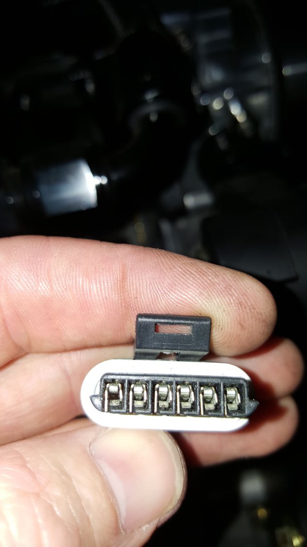

Ya had the car out on a drive to San Francisco! All was splendid until about my last 2 miles on the highway back home . Should be a easy fix just remove the side tabs off pop out the sensor and replace …think it’s 75.00 bucks for the part

check the pins on the connector, same crap happened to me when doing wot pulls and one of the pins in my connector was opened up and had a bad connection... tightened it up and all was well
Thanks I’ll give the pins a looking over …

Only does it every so often lol …..but I ain’t looked at it yet I’ll actually grab some lunch and then take a peak and set that straight ….in a few

Harness doesn’t stay connected properly…

Well so I’m gotta pick up another tps sensor and harness , & every time I run the a/c the engine starts heating up to the 240’s …shut the a/c off and back down to 219 it goes …thinking the radiator needs to go …or the a/c pump itself is working improper 1st off since the radiator was and prob still is full of bullshit road debris that can go ….switch a dewitts post pictures up as it comes along …tire of that p1516 out of no where especially in the middle of traffic how embarrassing!!!!!
