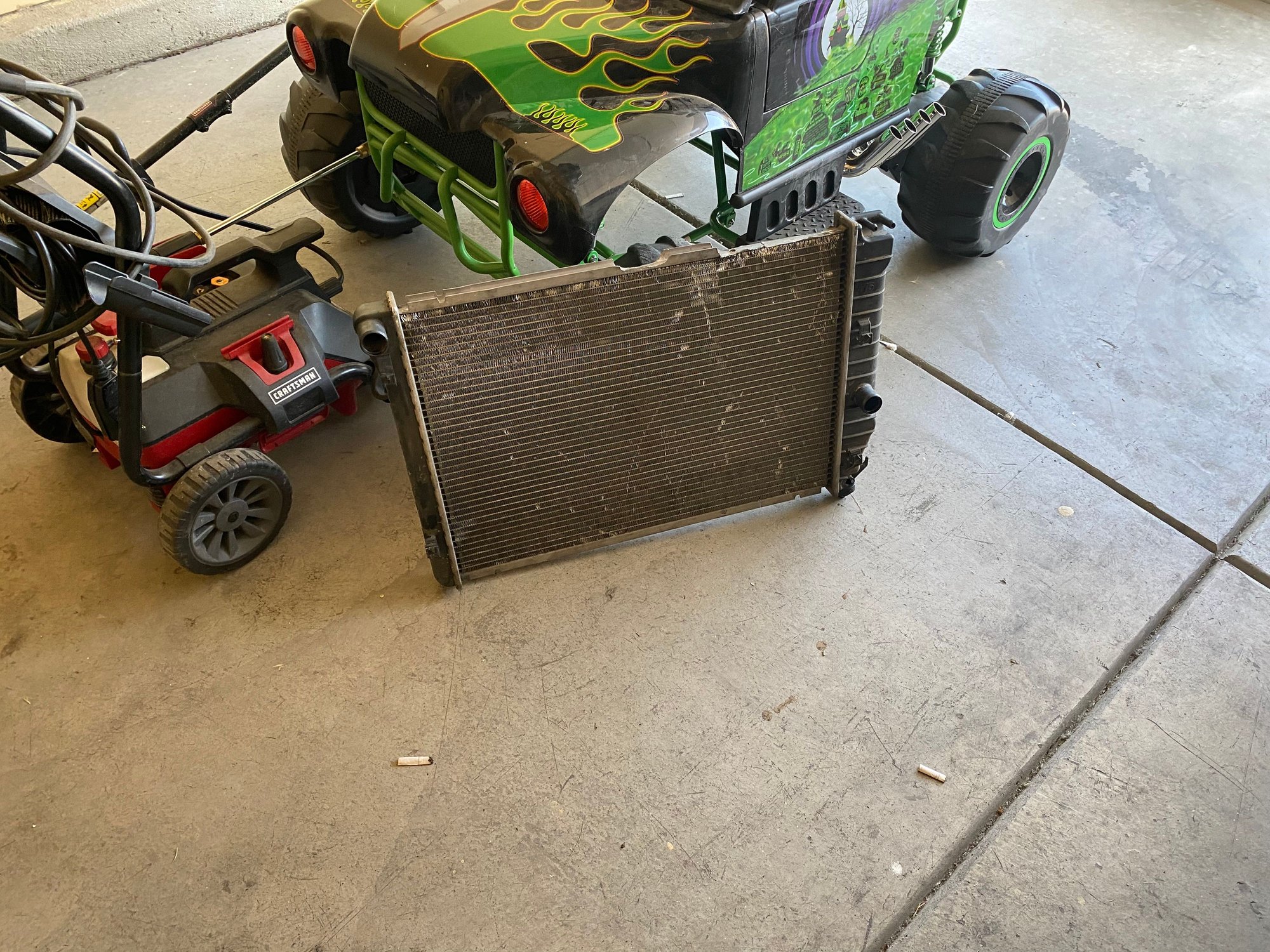

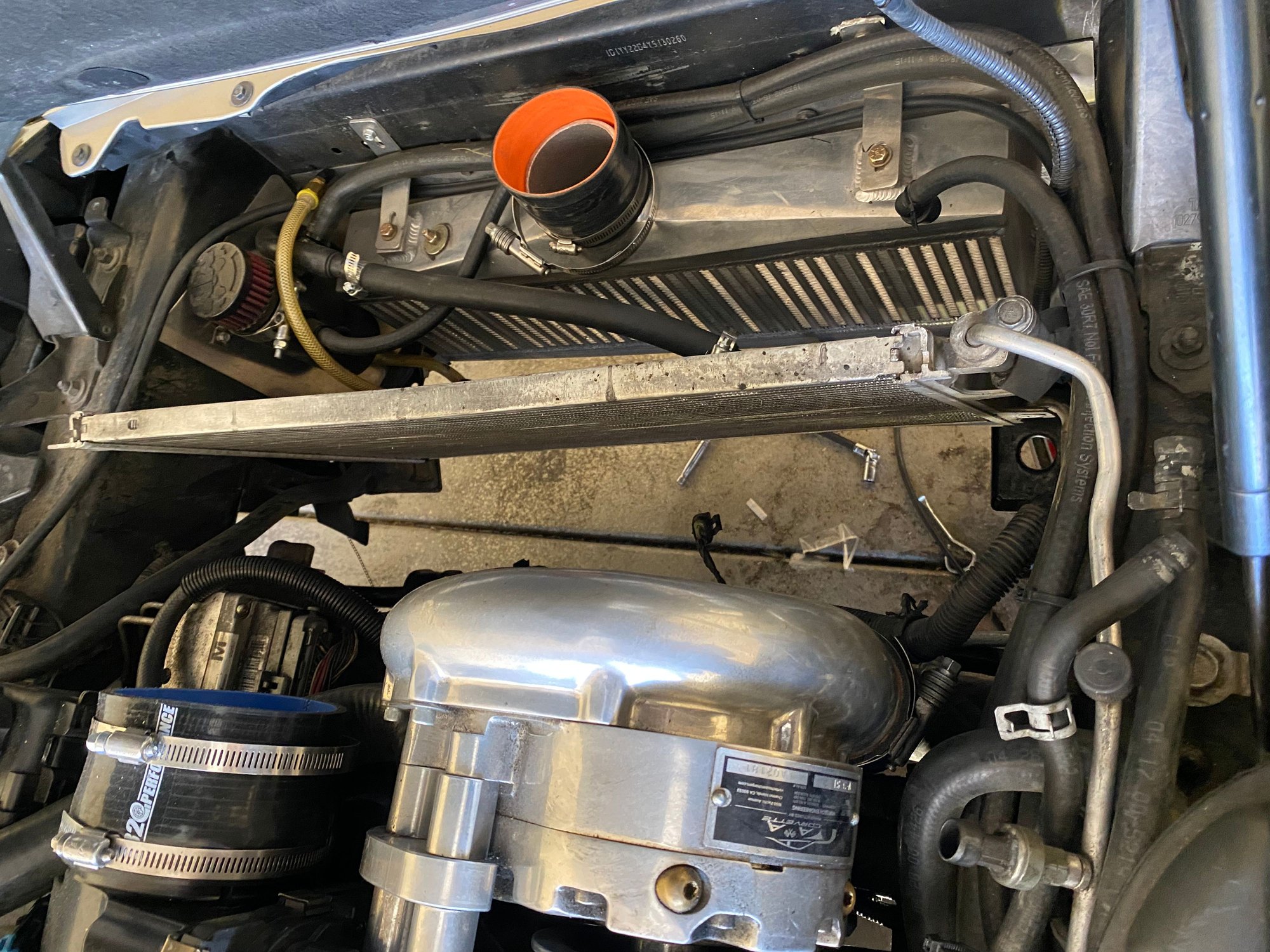

Prob give I’m the condenser another round of high pressure cleaning and a new radiator for sure ….seems like every summer

I remember you mentioned cleaning the radiator but did you clean out the condenser as well?... those get equally as dirty and with a setup like yours you really shouldn't have any cooling issues with the stock stuff... do you still have the air dam on the front bumper?
i got a air dam from the aa kit attached really it only spikes when the a/c is on past 3 bars …that radiator looks tore up from the floor up can’t really say anything better about the a/c condenser also …..

I know it’s gonna cost but the bigger aluminum radiator with bigger ports and more coolant is gonna be beneficial to coolant temps , lots of tlc
oh I found a broken hood light ground wire to just banging away at the sway bar bolts ….thinking I found why it spazzing out sometimes …cut and tape that sucker
managed to score a deal on the radiator dewitts direct fit for 529 after tax shipped to my door couldn’t see a know off who knows what metal for 350 or even the stocker prob for 200 …anyways I’ll be searching some hoses as the original are worn out at the ends and grab a few new spring clamps from the dealer ….see what I can do after about the ac condenser

the condenser is pretty shameful looking will see it’s not like I’m driving right now in this heat anyways
