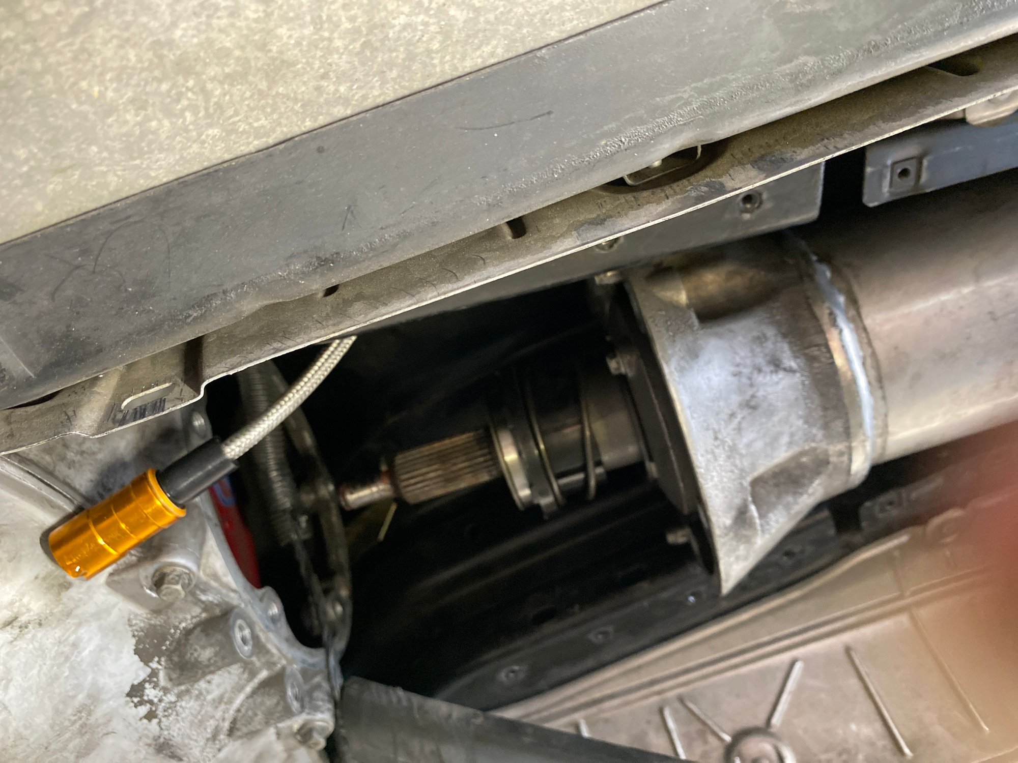

Old Sep 16, 2021 | 04:19 PM
  #747
Speedy007's Avatar
Speedy007
Joined: Mar 2018
Posts: 2,502
Likes: 187
From: California
4 bolts away from dropping this puppy!

From: California
Got the torque down and out after forgetting the shifter bolts lol I was wondering why it wouldn’t come out .
Feel better man ….

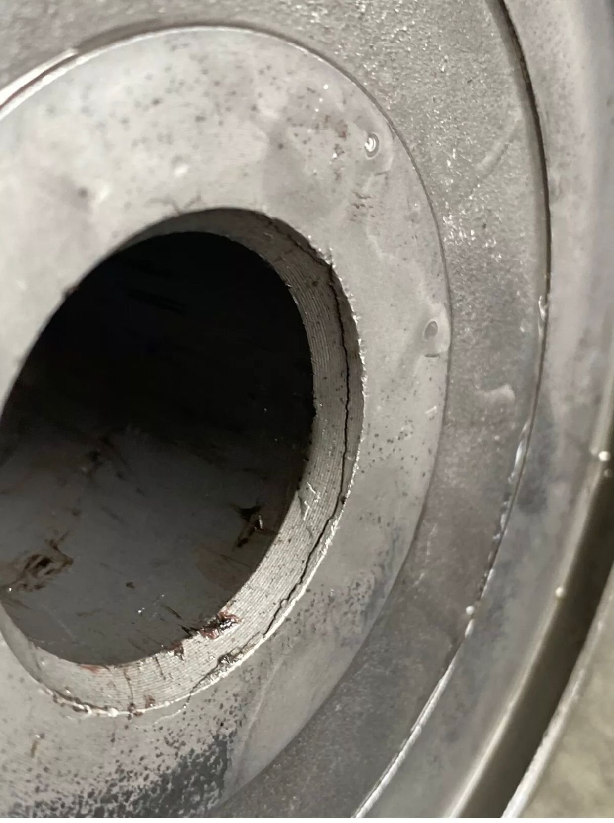

Old Sep 18, 2021 | 01:20 PM
  #753
Speedy007's Avatar
Speedy007
Joined: Mar 2018
Posts: 2,502
Likes: 187
From: California
Thought I would inspect it to make sure it wasn’t the line … look at that split middle right .. Luckily the manufacturer is getting a refund back… should have just gone with the McLeod from the start …
Old Sep 19, 2021 | 10:29 AM
  #754
helga203's Avatar
helga203
Joined: Jul 2010
Posts: 6,013
Likes: 726
Is that the fly wheel??
Old Sep 19, 2021 | 11:45 AM
  #755
Speedy007's Avatar
Speedy007
Joined: Mar 2018
Posts: 2,502
Likes: 187
From: California
That’s the back of the clutch actuator/ slave cylinder / hydraulic release bearing whatever u like to refer to it as
Old Sep 25, 2021 | 11:08 AM
  #756
Speedy007's Avatar
Speedy007
Joined: Mar 2018
Posts: 2,502
Likes: 187
From: California
The McLeod slave cylinder will be or should be arriving today then Monday Or possibly Sunday Night I can start putting this beast back together after work ….

Old Sep 28, 2021 | 11:28 AM
  #758
Speedy007's Avatar
Speedy007
Joined: Mar 2018
Posts: 2,502
Likes: 187
From: California
So after grabbing a oem and that busted bleeding it omg ..so I re took some measurement and then measured the stock slave without the spring adjusted to that exact height threw it on seems all is well now with the McLeod …almost all back together clutch feel a bit more stiff then stock so will prob take a little bit getting used to that action .
