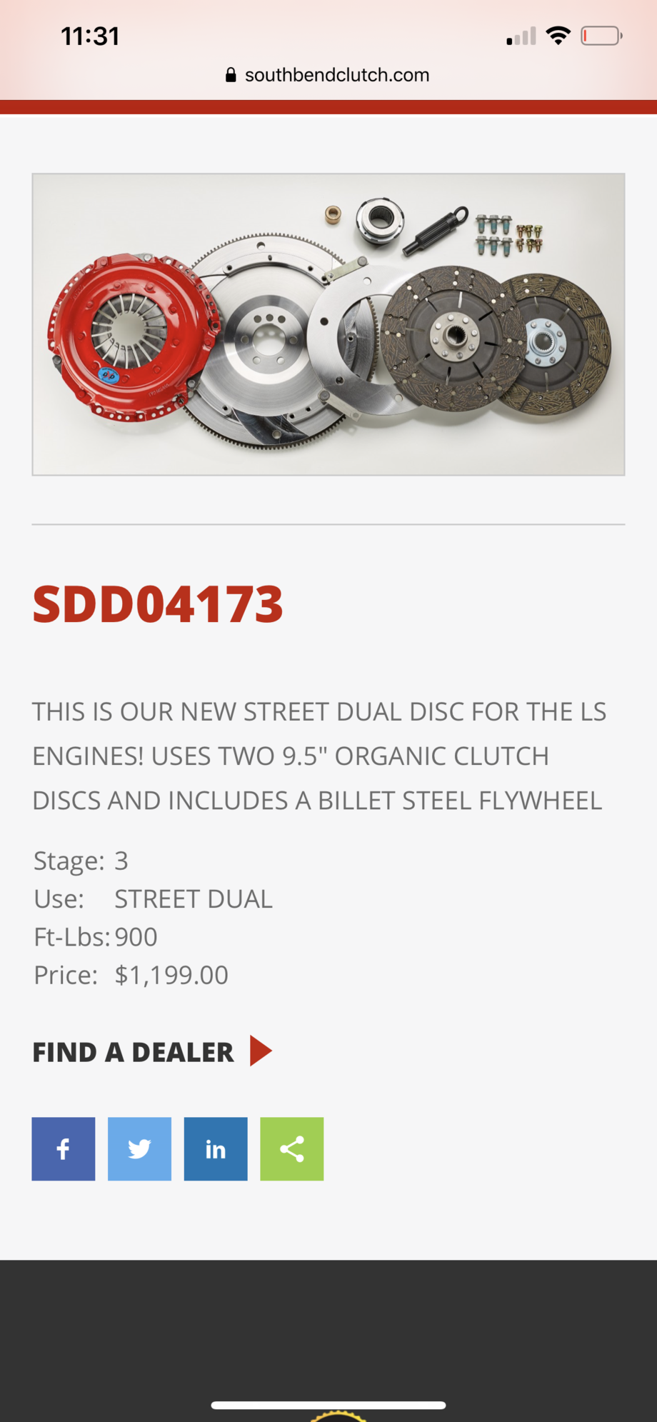

This is probably the proper upgrade for the car for longevity.

Originally Posted by evileight
Hey what part number clutch are using
If you also want to order one the guy I used to get it may also give ya the same deal I got .

I hadn’t either but the product looked well developed online plus the clutch place / guy doing the job have have 50+ years experience bxt the two of them left the computer open I got the hint this is prob the one I should use . After looking into South Bend they have also been around over 50 years . Anyways I got a good response from them on numbers for clutch rating label. 900 is at the crank hp for this clutch. The clutch looked badass assembled . Had to bring down yet another slave cylinder as the brand new gm part wasn’t closing all they way some lock out issue luckily I had ordered a spare and had it in hand .
