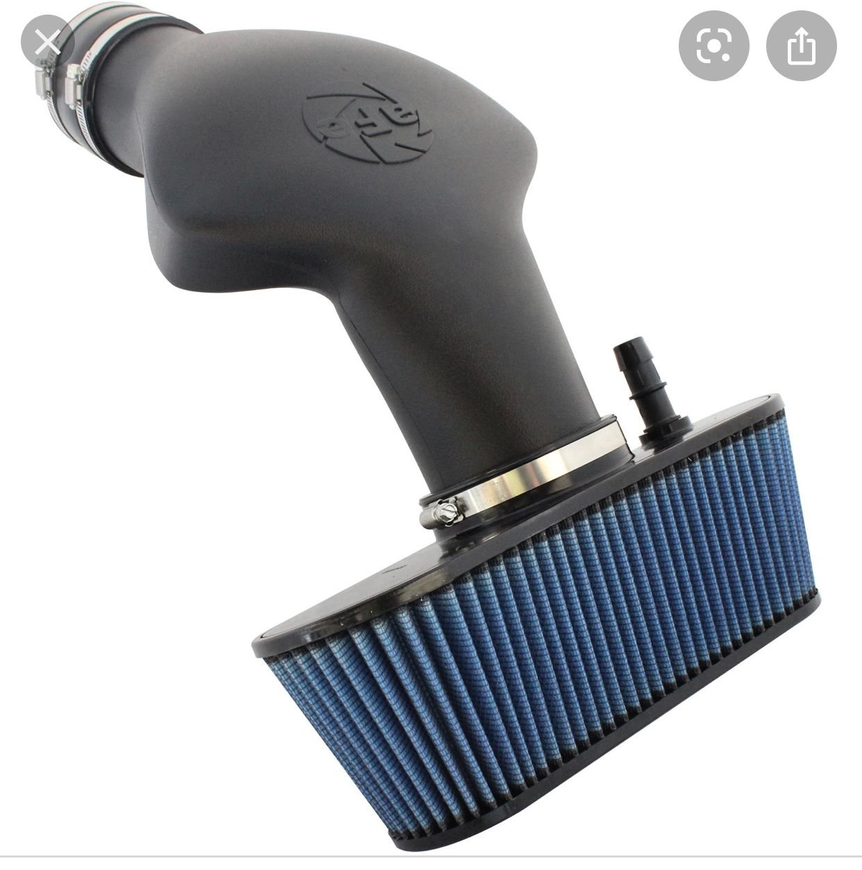

I need help to fit my 100mm ls9 card lsx maf onto the vara then to the inner cooler suggestions ? I’ve been struggling to attach it ! Everyone seems to want to take out the vara and run a bigger aluminum pipe not happening. It’s the original vara from way back !

It is in SD . I was told by the tuner car will not run if I switch the maf out .
Was the cat ever in the bag ?
Switching out the vara for a afe stage 2 this will allow the bigger maf to fit. getting the measurements it should work just dandy ! I. I bet it moves more air also.

I bought it mostly to clean up engine bay with a different style . Plus it’s carb legal . Also the pipe is 4 or 4.5 . I found this item stored away by someone in
the box never put on, again it’s one of the 1st to has come out. It should increase air volume in the plenum line.
Vara passed with a little paint but I rather keep it away given vara does not make this style of plenum no longer. It’s one of the 1st . They are shaped a bit different from the current design. It ought to be worth double if I ever go to sell so if the plenum is 100 now I’ll ask 200 for mine given it’s rarity. Maybe 250 when that day comes.

AFE intake came in today I got to say it’s pretty nice and a great deal as well. Hooked up nicely to the lsx 100mm maf . All solid black love it. Awaiting a Tilton clutch slave cylinder actuator for the row out bearing. As I the new gm ls7 z06 cylinder blew apart in the braided line or at the neck. Waiting for parts to start tearing it down for the 2nd time in less then a month and it sucks. But this go around will be a little different. With a tick adjustable master cylinder as well . Figured f**** it . Ordered a 48 inch speed bleeder as well . New reservoir tank . Taking off the old intake putting on a new fast LSXR 102 . Taking off the stock rails adding the fast 102 rail set up they look stock but more beefy. Coolant steam vent relocation kit to fit the intake without hassle. New fast intake cathedral port seal to match the intake as I don’t think fast is providing them with the intake . Again I got the intake at a huge discount through a branded speed shop new. Map sensor relocation extension harness 28 inch to the front . Think I must must drill and tap new Harley Davidson map sensor seal got a pack of ten . Map sensor clamp kit . Intake 4 bolt to 3 bolt throttle body for the moment or I just might buy the nick Williams with the adapter unsure still. Either the adapter was 39 bucks not bad . New knocks sensors from gm with harness . It should be good to go after with no issue other then a little tune adjustments. I’ll prob end up buy the 102 electric throttle body and adapter and sending back the adapter as I continue to think about it.
