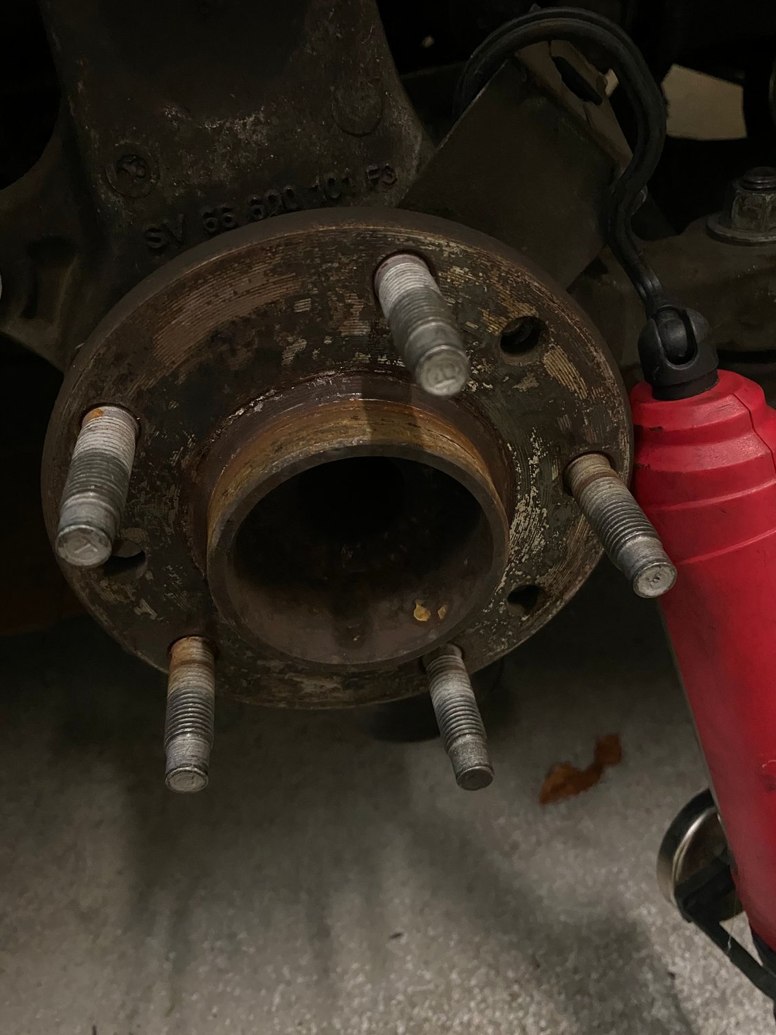

Wheel bearing out and the whole inside is filled with 20 years of nasty dirt and grime looking better waiting for parts !

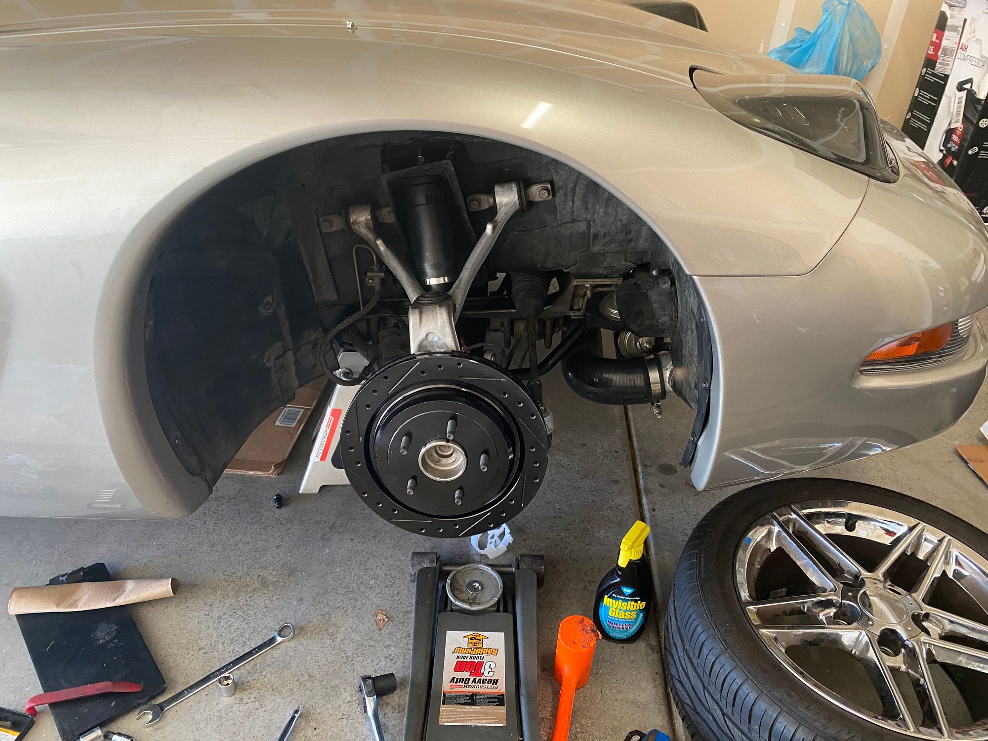

I’m still getting a rotor rub I don’t know why this is happening ! New wheel bearing new rotors and brake
It’s coming from the part that hold the pads any ideas of what’s going on?

When I tighten up the wheel lugs wheel becomes very hard to turn it locks up loosen lugs nuts it spins

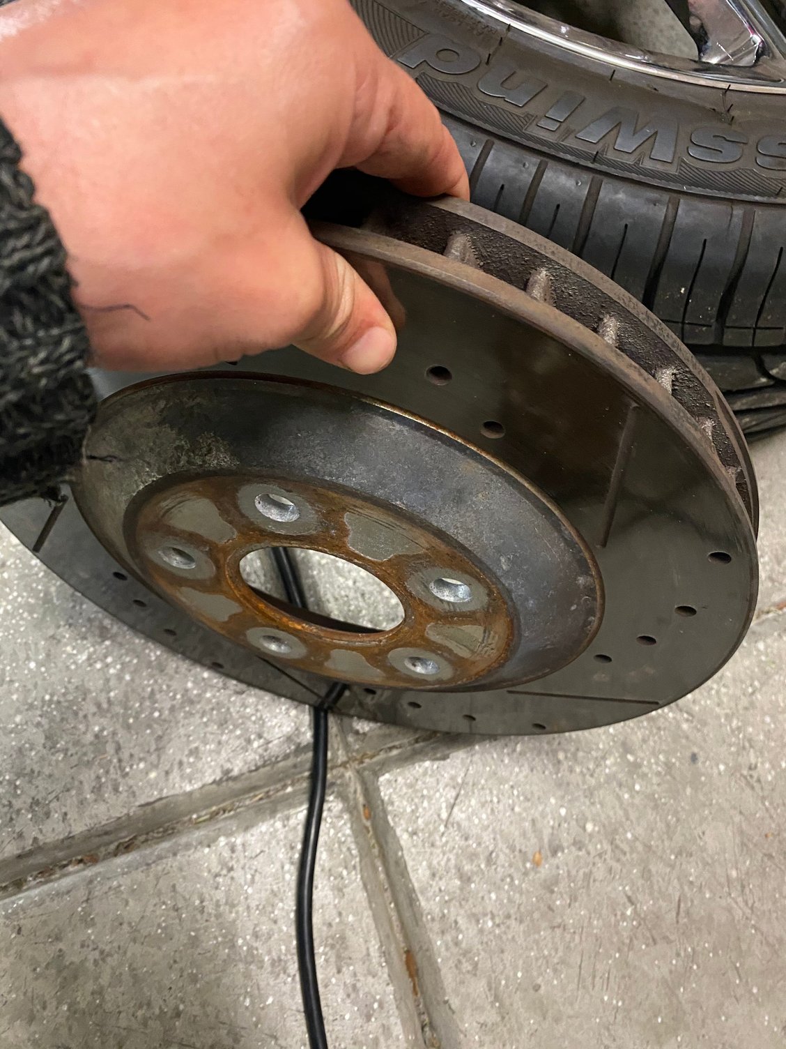

Well it helps when your putting the correct front rotor on and not a back rotor I was like dam that rotor looks smalll maybe I should check boxes

Side 2 was a breeze !
