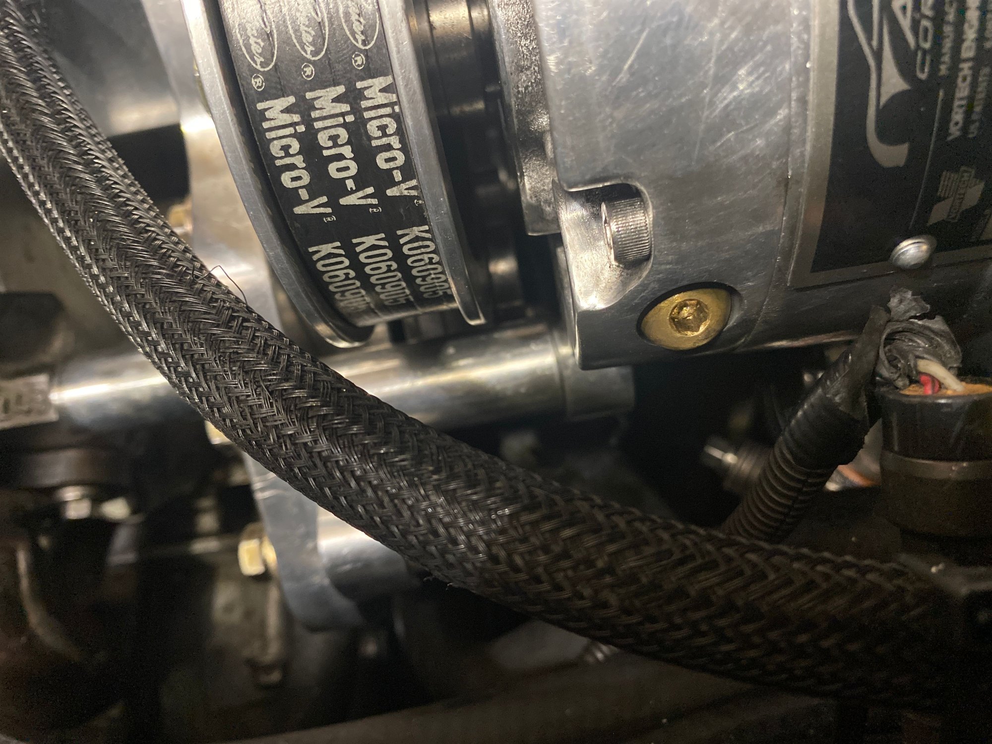

Just got done getting the unit back in aligned up clamps tightens . Seems the 90 7/8 is a little harder to get over the alt pulley new but it’s there and seems a lot better fit then the 91 inch I first got with it and still there’s some wiggle room to adjust later on but seems tighter then before . So ya Gates Belt
90 7/8 13/16mm . 6 rib . Works .
What size blower pulley do you have on there?

3.8 it was suppose to be .

Jeez I forgot what a pain it is hooking up that belt what a friendly reminder ... I found keeping the alt bolts out and then attaching the belt worked better . Later on get on the tensioner spring and insert the alt bolts . Think it’s a better aligned the. Before I guess maybe a hair or two more on .

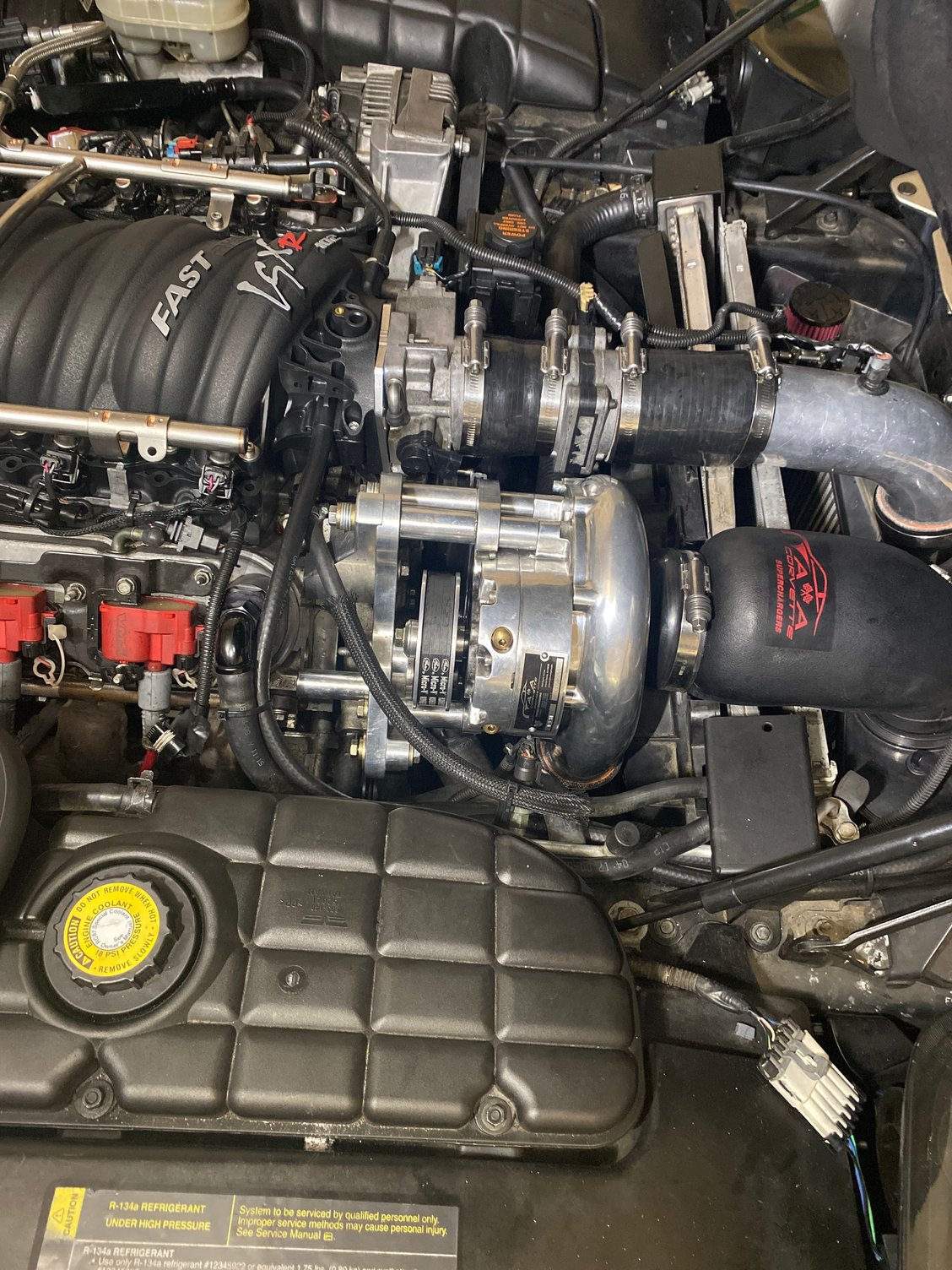

Now to the next gm fun step hooking up the air intake to the blower I know this prob ain’t gonna be easy as well just like everything else on this car .
Well...hey that went better then expected straight forward put the coupler and clamp on the blower then fit the intake plenum with air filter on . All hooked up. Tighten down the steam lines release any captured air and hopefully it’s good no more squeaking . If so then the power steering pump is coming off and getting replaced . I’ll be sure to move the belt out of the way this time so it don’t get soaked .

If you're using a 3.8 pulley and standard diameter balancer, the RPM Gates belt p/n recommended by A&A is K060910RPM. If you're using a standard Gates belt, it's the same p/n sans the "RPM". Gates shows that to be 91-5/8"...maybe that's why you're getting frustrated with a belt change. Belt too small?

That’s the part number I got from aa yesterday the problem has always been since day 1 that belt never fit right . Seemed a bit to loose maybe they sent me a 3.6 pulley I dunno . But the belt I got now will be permanently used on every replacement for as long as the supercharger remains on it it’s a good fitting size
But this Gates k060905 does fit nicely . 90 7/8 , 13/16mm .
